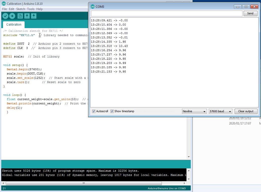

Calibration:
1. Upload the following code to Arduino from IDE.
Code:
1.  /* Calibration sketch for HX711 */
2.  #include "HX711.h"  // Library needed to communicate with HX711 https://github.com/bogde/HX711
3.
4.  #define DOUT  2  // Arduino pin 2 connect to HX711 DOUT
5.  #define CLK  3  //  Arduino pin 3 connect to HX711 CLK
6.
7.  HX711 scale;  // Init of library
8.
9.  void setup() {
10.   Serial.begin(57600);
11.   scale.begin(DOUT,CLK);
12.   scale.set_scale(1252);  // Start scale with a calibration factor. Adjust the factor.
13.   scale.tare();       // Reset scale to zero
14. }
15.
16. void loop() {
17.   float current_weight=scale.get_units(10);  // get average of 10 scale readings
18.   Serial.println(current_weight);  // Print the result
19.   delay(1);
20. }
2. Open Serial Monitor on Arduino IDE. Numbers start to flow. They should be close to zero at this point.
3. Put a known weight on the scale. If it is off from the actual weight, increase or decrease the calibration factor in the line 12.
4. Remove the weight from the scale.
5. Upload the code with a new calibration factor.
6. Repeat 2~5 until the result matches the actual weight.

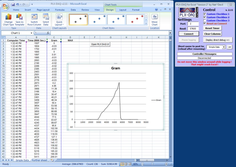

2. Open PLX-DAQ on Excel. Allow macros to run. There will be a spreadsheet and a dialog, if it works.
3. On PLX-DAQ dialog, change the port number (to the serial port number obtained during the prep) and the baud rate (to 57600).
4. Close Serial Monitor or Serial Plotter on Arduino IDE.
5. Start logging. Data will flow into cells.

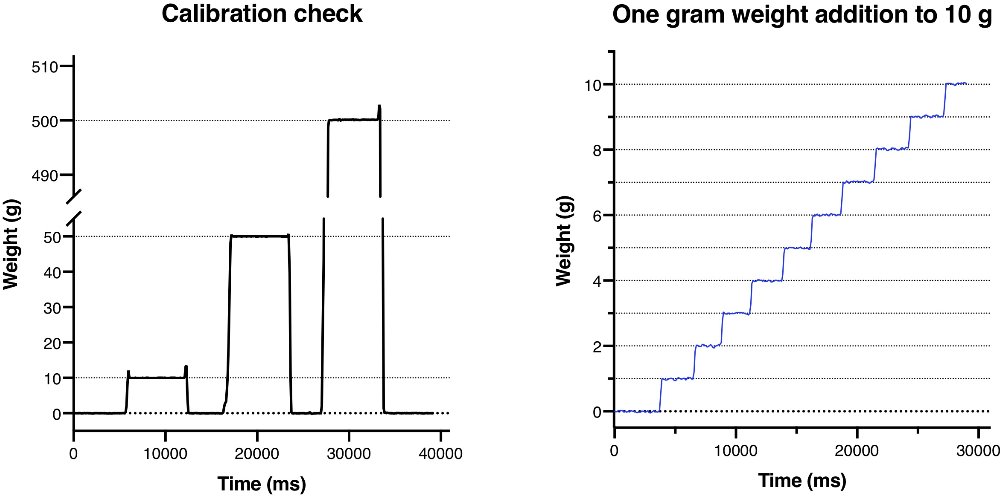

I have checked the calibration and accuracy of the tester using known weights.
You can see that the responses are quite accurate in a wide range and to at least one gram.

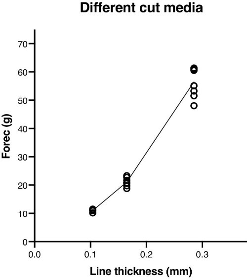

Then, I measured force required to cut fishing lines with different thicknesses using Feather Hi-Stainless blade.
The values were quite consistent at each thickness.

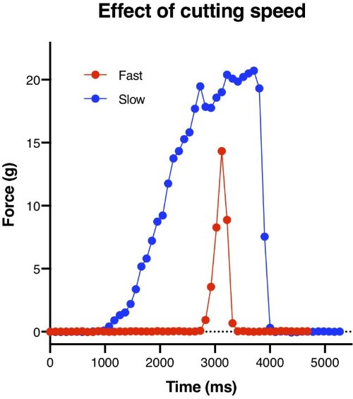

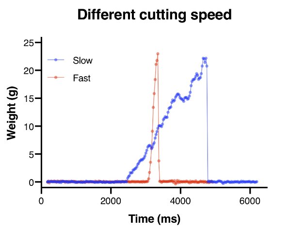

However, the speed of pushing down the blade affected the result significantly with the 10 Hz sampling rate.
I can get very consistent values at each speed.
But I hope that a higher sampling rate would eliminate the difference.
I got a 80 Hz AMP/AD converter and tested it.
At this sampling rate, the cutting speed does not matter.
I can be careless in how I cut the media, and still get quite consistent numbers.
Now, I can start real testing.
Edit: The sampling rate was limited to 40 Hz in this test because PLX-DAQ did not like the baud rate.
It works at 80 Hz now with a reduced baud rate.
This result suggests that PT-50A tester is also cutting speed insensitive, as it allegedly works at 40 Hz.
