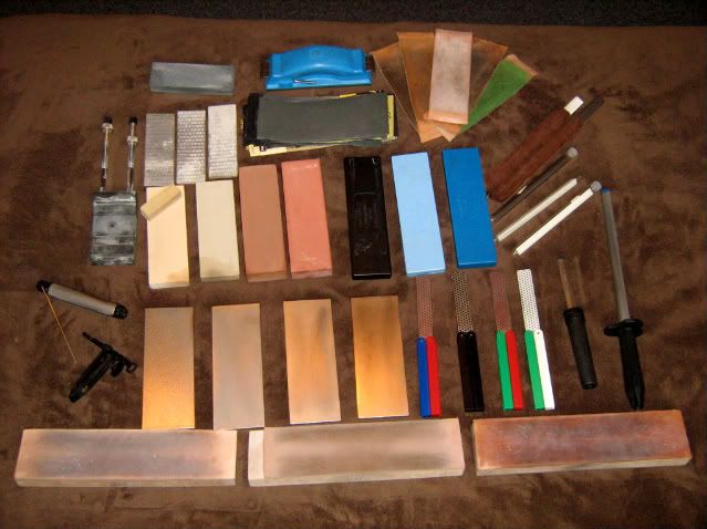

First, please let me thank the many knowledgeable and helpful people on this forum.
Next, let me say that I am something of a stone collector. I have plenty.
Last, I would like to get a "difinitive" set of DMT Diasharps. And I would greatly appreciate any help all of you can provide with the following questions.

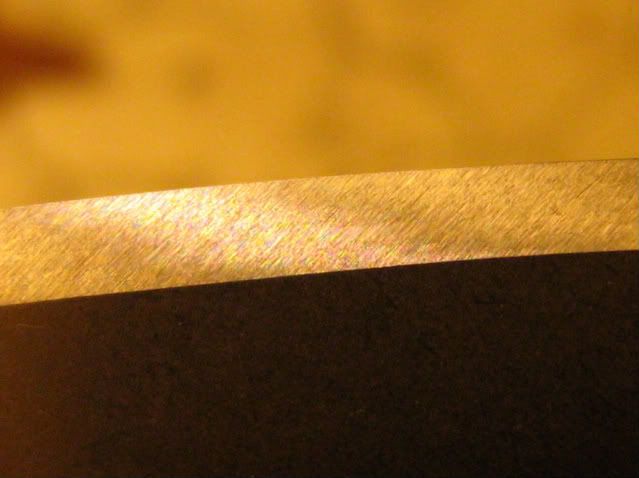

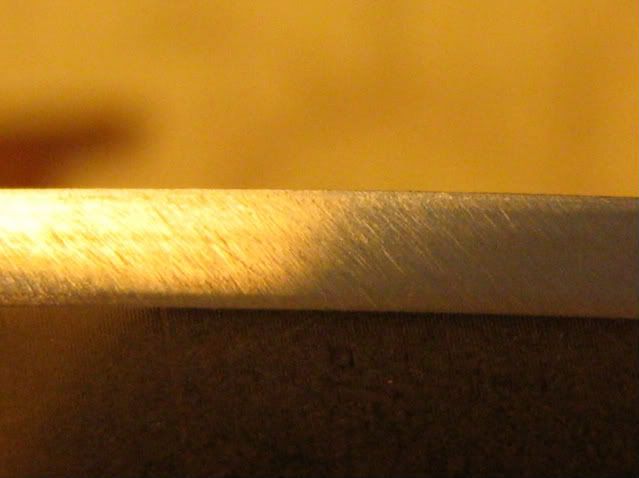

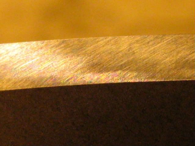

X-Fine
XX-Fine
XX-Fine with outdoor lighting
Yes, scratches goes in different direction and first picture zoomed up 20%.
But after Chromium Oxide I have mirror surface without any scratches at all (at least under microscope I do not see it).
Thanks, Vassili.

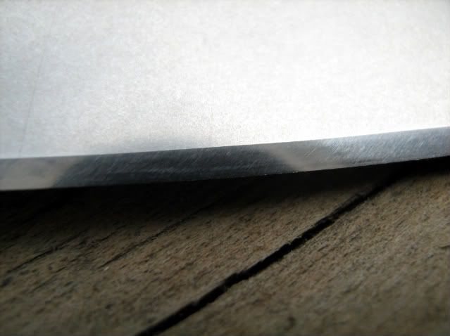

I'm seeing a mirror edge after just the EEF stone.
Here's what I'm thinking. You're scratching off metal. Now these scratches on the course stones are deep and ugly. Jumping to a much higher stone (EF) will give you polished course scratches. Moving sequentially across the grits will give you a finer and finer scratch pattern, and then when you strop, you're not going to have mirror topped scratches, but a pure mirror edge.
Sorry about the zoom here are the ones I should have posted. Is the direction of the scratches really that big a deal? Why are you trying so hard to not believe the facts? You don't think jumping from 9 microns to 0.5 microns is too much.
I disagree. If you spend enough time on the finer grits, you'll eventually get all the way to the bottom of the deep scratches anyway. It might take a little bit longer, but you'll get there, and you'll have removed less metal in the process.
