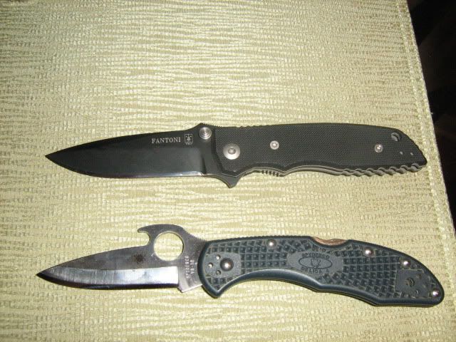

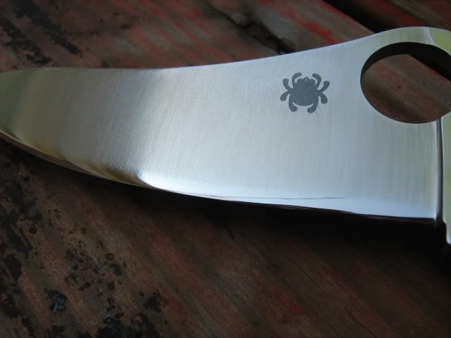

First of all, thanks for the advice. I was hoping you(Knifenut) would chyme in as I have read a lot of your posts. How do I know which one of these bad boys do I have(saber or FFG? It is a regular blade with no serrations.
Saber ground would be a grind reducing the full thickness of the blade starting at around the half way point of the blade. FFG is a complete flat grind down the side of a blade.
Both of these are saber ground
This is a Full Flat Grind
