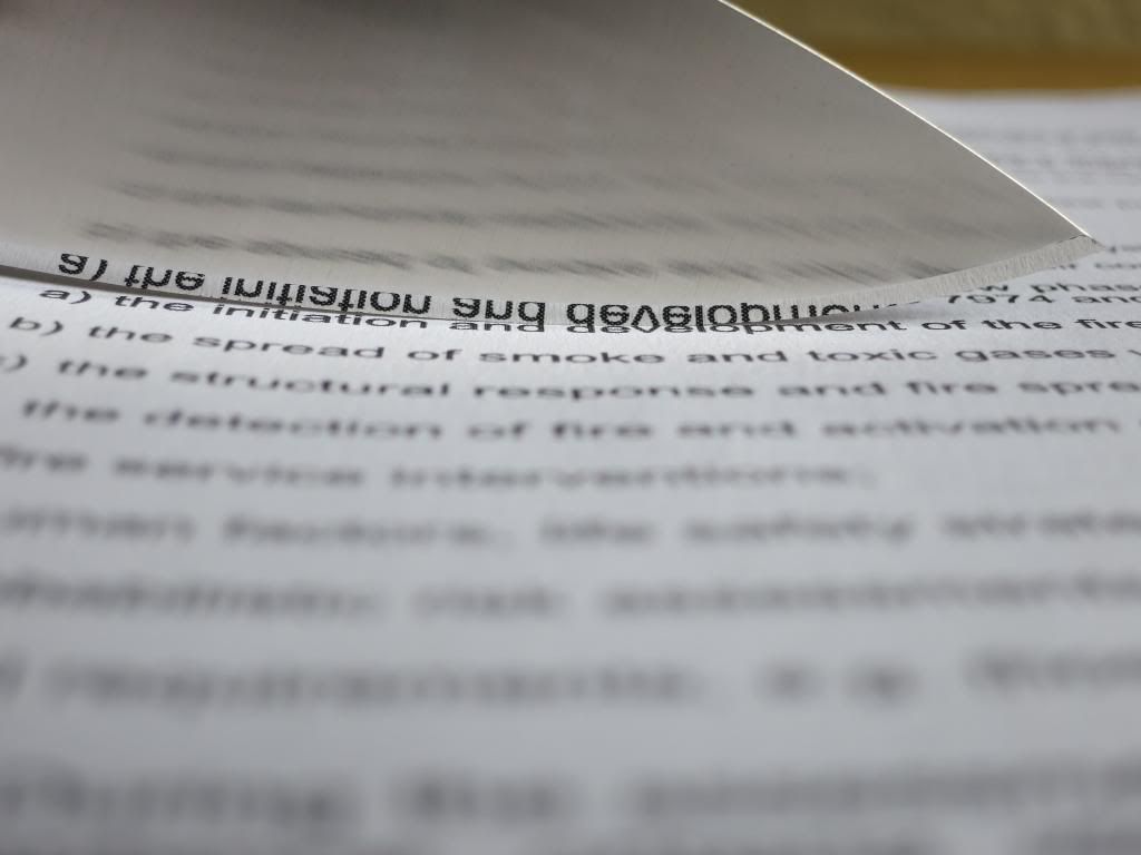

So back to the ACTUAL topic of this thread - the compounds, not the strops. Here's another picture of an edge produced using 0.025 micron polycrystalline diamond.
