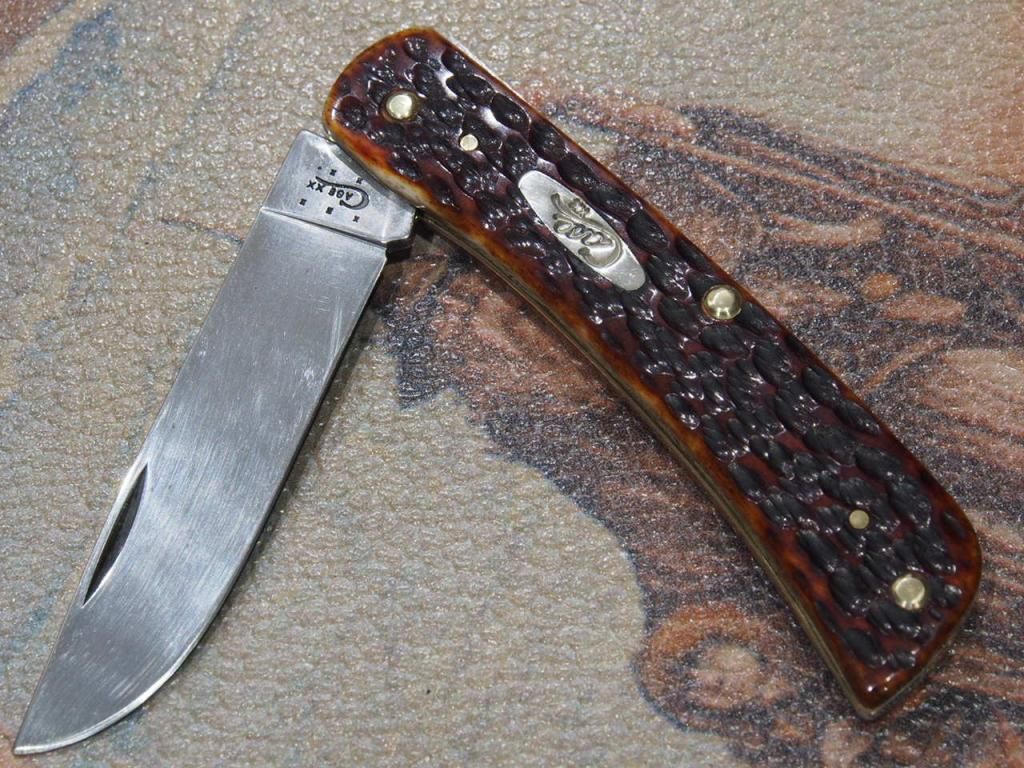

One more thing to note is that the case chestnut Sodbuster doesn't have bolsters, even though the sodbuster pattern is said to be a hard use pattern. I have been using mine very hard at work, and it has developed some play, although I later fixed it (VERY CAREFULLY!) with a ball/peen and anvil. Bolsters help with easily fixing bladeplay with a much lower chance of the handle cracking.
