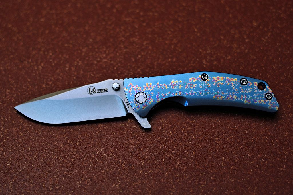

Are bearings necessary? No. This knife is one of my best-flipping flippers, and it's on washers:
That said, I think it's probably harder to get a washer flipper right; if I tighten down the pivot on that Kizer 3404 a quarter turn past perfect (flips great, no play) it won't flip that well any more.

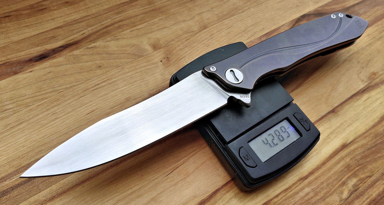

On the other hand, this CKF Milk has the best action of any knife I've ever handled (Shiros, Thorburns, etc. included) and even if I over-tighten the pivot it still stays so free-swinging that I find it slightly disturbing:
I think it was Officer's Match whose similar claim made me seek out a Milk; he was entirely right . . .
