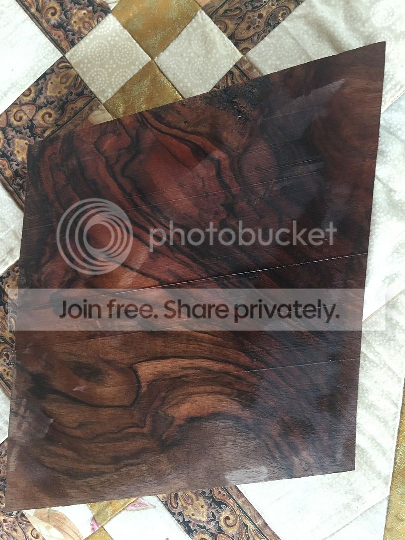

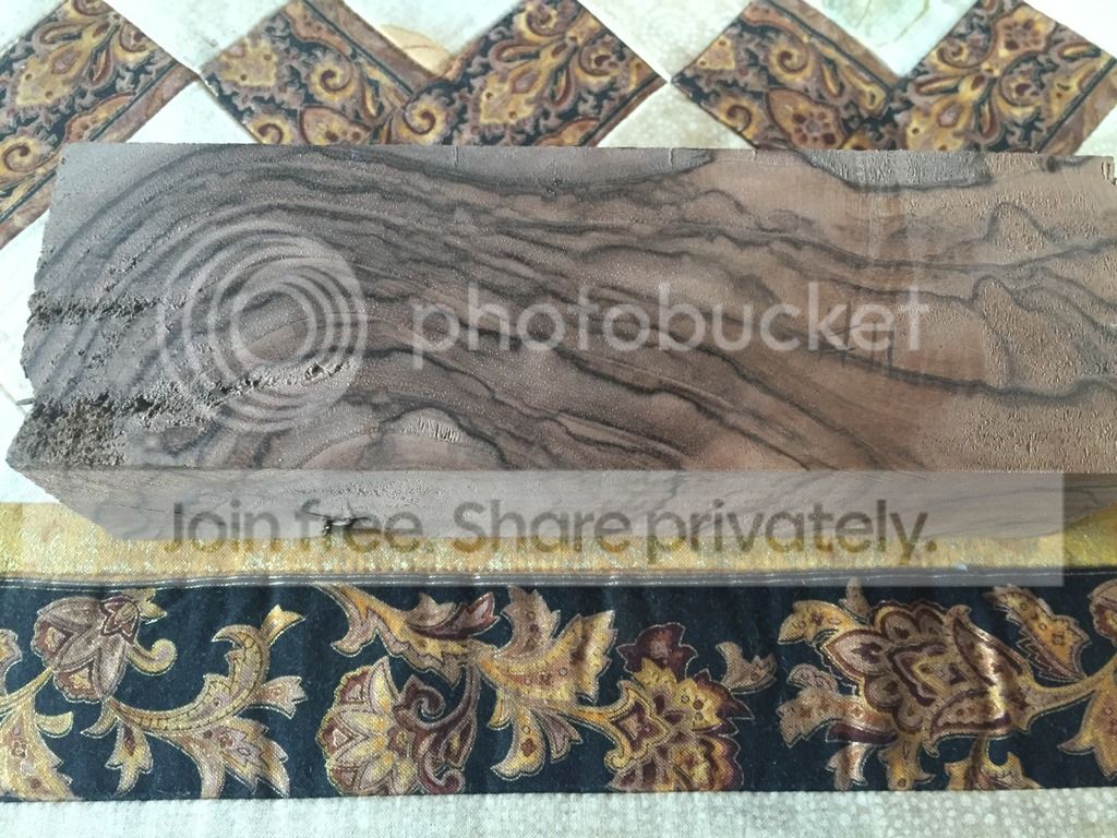

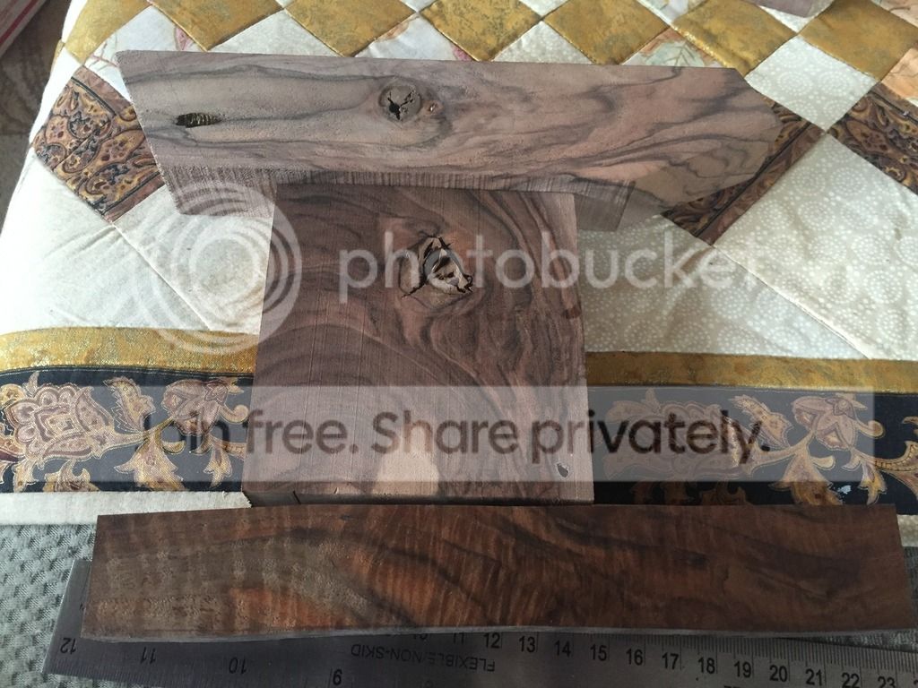

I was given a box full of English/Black walnut graft wood. Some of it is slightly burled, and much of it has fiddleback or curly grain. Included in the box was a few pieces of relatively plain grained pistachio. The walnut has been seasoned for 1.5+ years, and the pistachio 5+ years. Do I need to have any/some/all of it stabilized before using it for knife handles?
Some wouldn't stabilized walnut, but I like to stabilize everything. You will need to check the moisture content before sending it off to be stabilized. I'd love to see pictures.
Stabilize it. Do the best pieces first, and after that has been used, do the rest.
Walnut doesn't HAVE to be stabilized but you wont regret doing so. It makes finishing a lot easier. Also, stabilized wood lets me sleep better. LOL
Yep on stabilizing everything. It costs but is worth every cent.
It took me long enough to get pics done. Enjoy.
I opted to stabilize most of it. Now I'll just impatiently wait for K&G to send it back.
