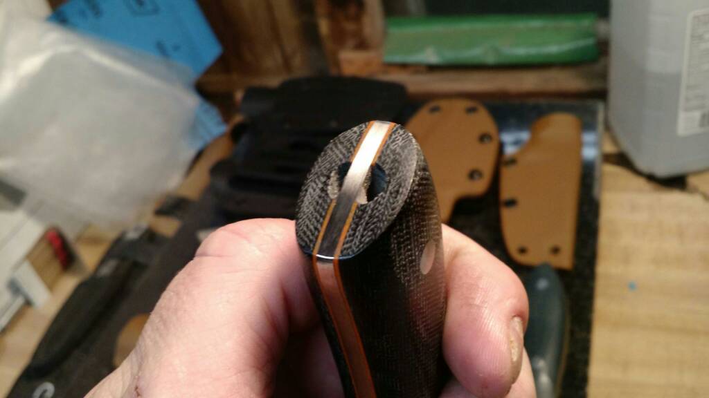

I put a hidden lanyard tube in most of my small drop point hunters. If they want it, it's there. If not, it isn't as noticeable.

What is that insert? How is it attached?

Stainless , cut from round tube and glued with epoxy .Three times I cut pieces until I hit a real pair [emoji106]
my mind can't work out how you get that half dish shape from cutting a piece off a round tube [emoji15]

In the simplest method, just glue the tube in the channel made with a matching size cylinder bit and saw/grind it flush. You can also pre-cut the tubing at an angle to get less to grind away.
