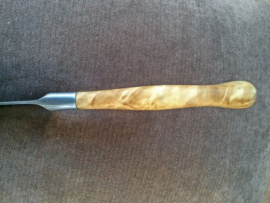

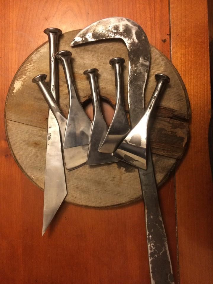

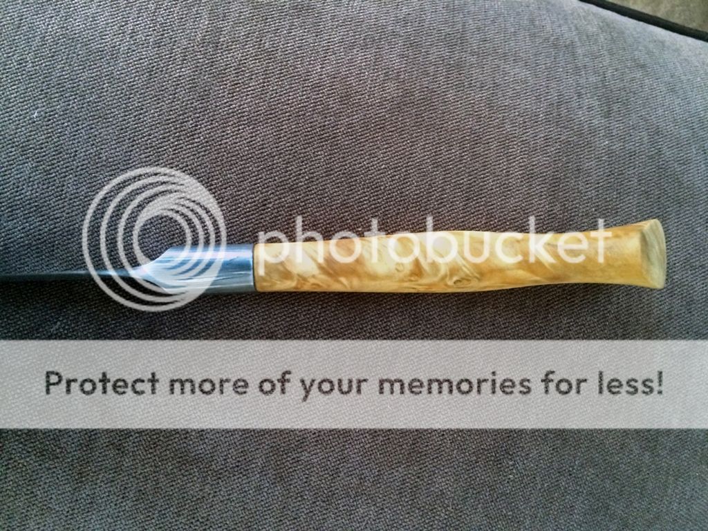

Personally I think girls belong in the kitchen, guys belong in the kitchen, everyone belongs in the kitchen...that's where the food is! As for the shop here's my first finished kitchen knife, it's a belated wedding present for my brother and Sis-in-law. It's a whole different deal forging these things, they're so thin and grinding them is like grinding a noodle. Looking forward to the Seattle show where I can pick up some advice from the pros. In the meantime all comments/advice welcome! The blade is 5 3/4" X 1/16 OAL 10 5/8 1080 and 15N20, with a box elder handle. Speaking of wedding presents here's another one I finished this week. Around here starting life together often means some serious time in the boatyard fixing up a new-to-you vessel to get ready for fishing season next year. This is a set of caulking and reefing tools. Now before you make any smart comments like (Whatdya pound that outa somethin hot with your eyes closed?!) keep in mind that while I'm fairly comfortable making blades I'm a very cut-rate blacksmith. They aint pretty but they do fit their boat seams. -HD
Looks very Nice Haley, has a much better shape to it than most of the santoku That I see posted here. It could use a little more belly(curve ) in the edge especially near the tip but it is certainly usable as is.

Thanks for the comment Bill, I think I see what you mean. I'll remedy it on the next one.

My answer to the title question would be Yes, and to both. Of course, its a lot more fun being in the kitchen when you've got a knife like that one to use. Looks like a good first effort, and avoids many of the problems "field knife" makers make when they venture into kitchen knives. Look forward to seeing more.

They aint pretty
I disagree. I think they look pretty darn good. Now, if I only knew what "reefing" meant . . . . I'm guessing its sorta the reverse of caulking.

Love that knife, Mrs. Desrosiers, and really dig those tools. Cut rate nothing!

Women belong anywhere they want to be. LOL I agree that you may want yo ad a little more belly in the middle of the blade then towards the tip. The rocking motion is fairly standard with the Satoku but I have had a couple ordered with less curve lately?
Your blacksmithing work looks great to me!

That handle looks really comfortable, love the shape and material.
Don't know a thing about boats and ships (I do cars and motorcycles) so those implements look a little scary to me :eek:
