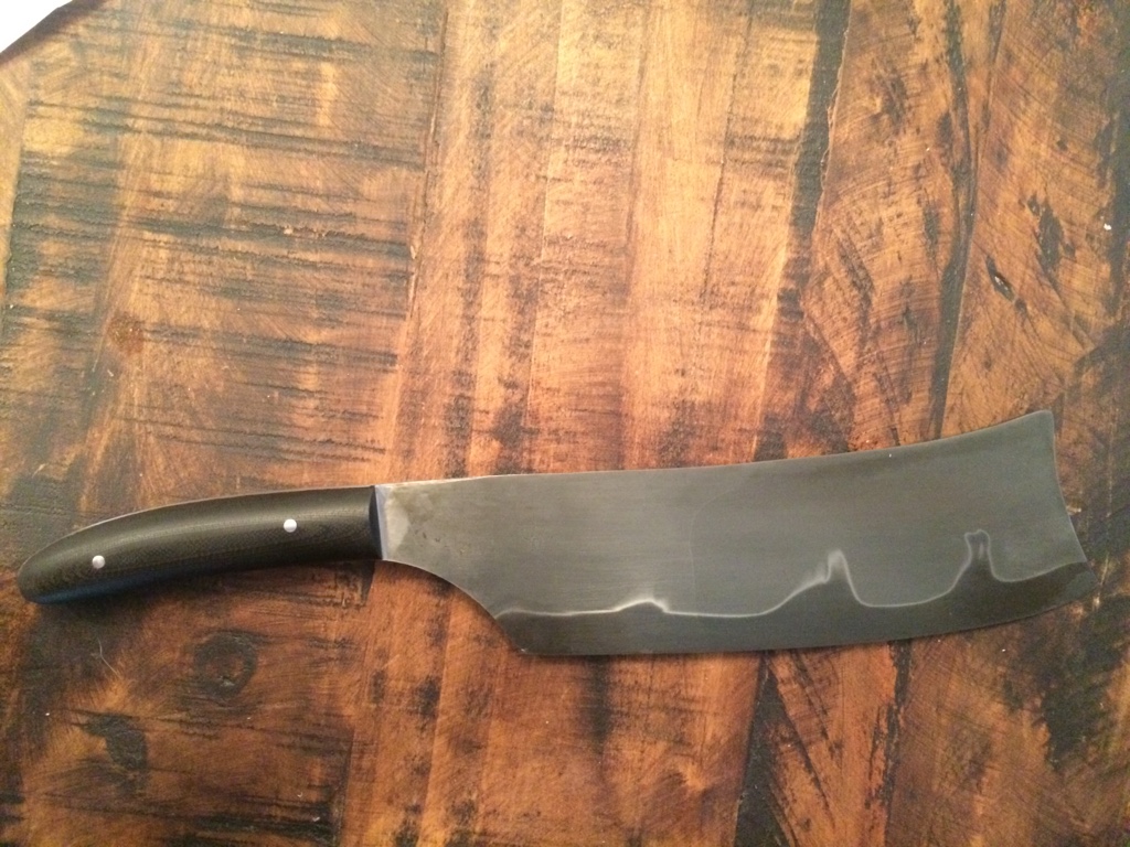

The first picture is 1084. No clay used. I used an oxy acetalyne torch method taught to me by mastersmith Jim Crowell.
The second knife is 5160 cleaver using same method without clay

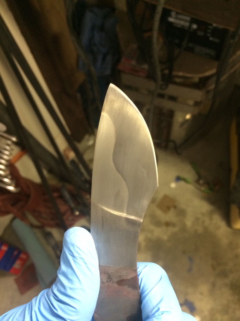

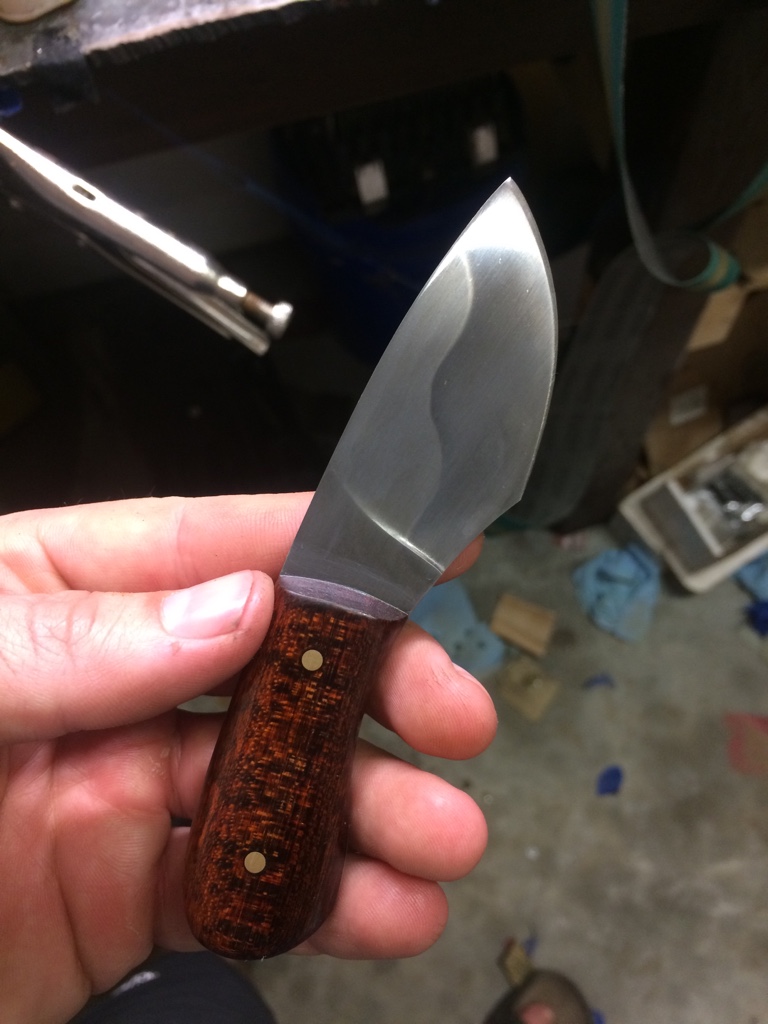

Stacy has forgotten more than I could ever know so take anything he says as gospel. These are just my own very very limited experiences. Here is that same 1084 skinner at 400 grit. You can faintly see the hamon.

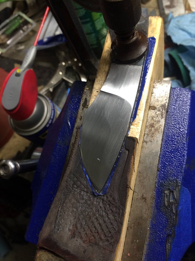

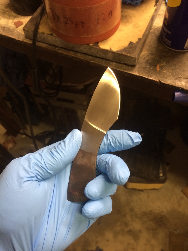

Then brought up to around 800 grit I get it ready for etching
Right after the mixture

Wow, Clive, that's neat. How did you get that pattern without clay? That's really cool!
A dark room and an acetylene torch. You basically sit down by your quench and "draw" with the acetylene torch. You start at the bottom ricasso end and slowly heat from ricasso to tip. Get a red hear then move on. Keep on moving the red heat to whatever pattern or depth desired until entire cutting edge is glowing red. Then quench quickly. Then temper as normal.
Yes, the edge quench or edge heat gets a hamon like pattern, but is slightly different than a true hamon. In a hamon, all the steel becomes austenite, and in the quench, the edge cools quickly o miss the pearlite nose ( and becomes martensite later on). The clayed area falls behind the nose and becomes pearlite. The border of these regions is a cloudy mix of pearlite, and martensite ( it used to be called troosite in the days before SEMs). There are different type and size floating martensite crystals in the matrix in and above the line.
In an edge heat/quench HT, the spine usually never gets to austenite (remaining pearlite), and only the edge converts.
