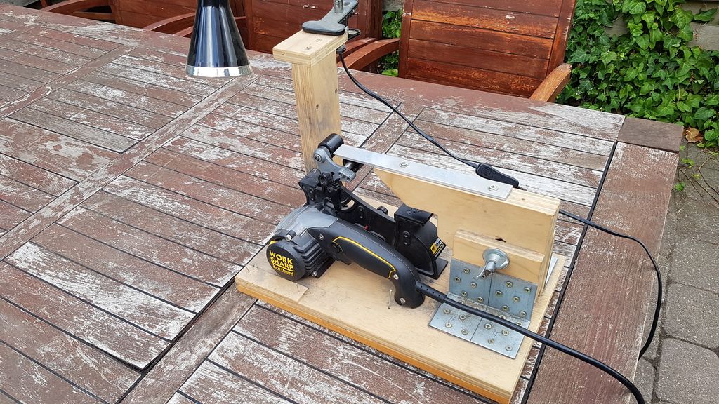

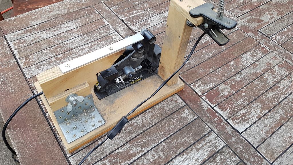

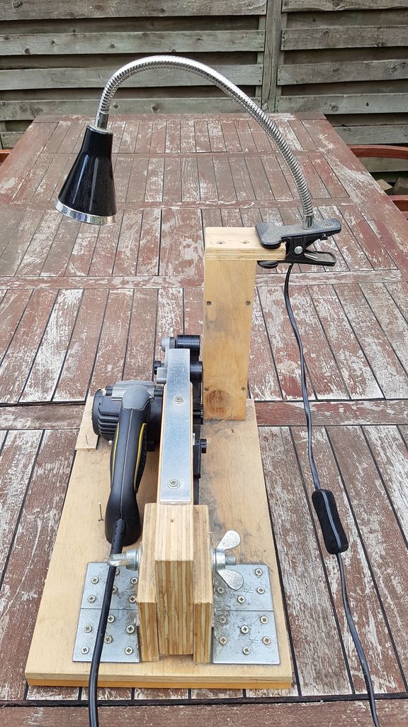

Because I have never really trusted myself to keep the knives at an exact angle, I have built a jig around it, so I have support for the knife blade while I’m sharpening it. The knife blades rests on a piece of aluminium flat bar, because this material is much softer then any blade. As a result, none of the knives I have sharpened have ever been scratched. One of the main complaints I have heard of the Work Shap is that the edges get somewhat rounded, but when I use this setup and only use the lightest pressure against the belts, the edges get very flat. Much to my surprise, I haven’t got a picture of my setup, but if you are interested, I will be happy to post a few.

Thank you! This is all awesome info! Can you please post some pics of your worksharp jig? I’d love to see it!

Finally! Here you go...

So did you not like the stock blade angle block so you made your own with the Aluminum bar?
Very nice setup. :thumbsup:
