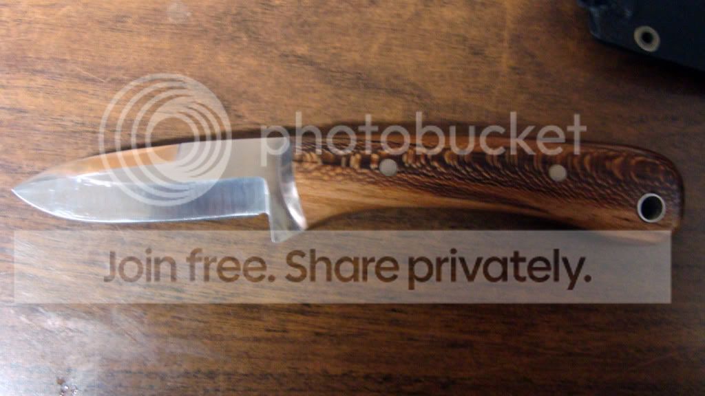

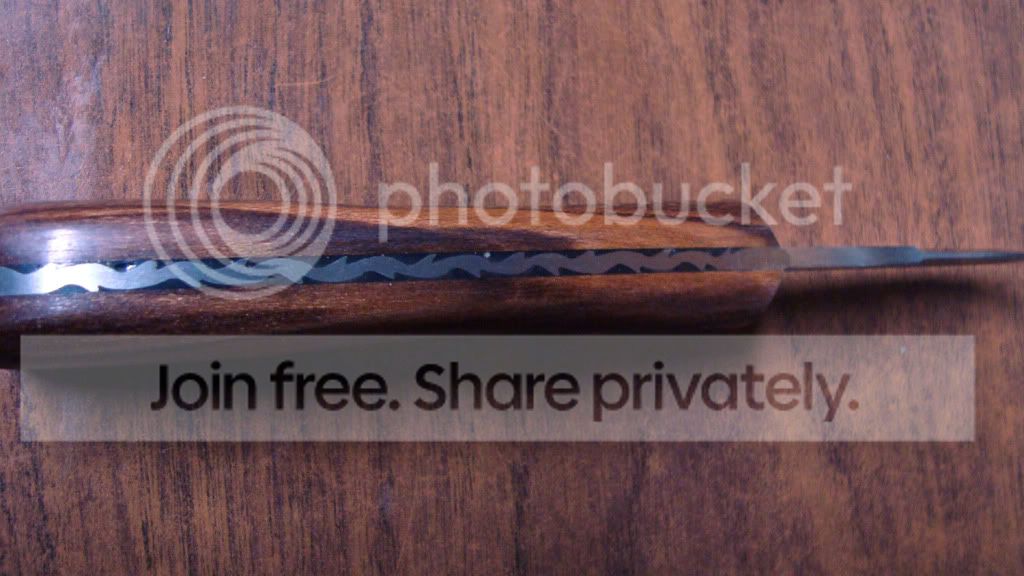

I was just wondering if anyone else here practices. I often find myself taking a piece of scrap steel or wood and practice certain aspects of knife making. Things like file work, bevel and swedge grinding, handle shaping, leather carving and tooling, and the list goes on and on. A few times these practice sessions have actually turned into a complete practice knife that gets snapped up by my brother. He likes my knives and even though they are imperfect practice pieces he likes to show them off to his friends. The latest one that turned into a knife was my first attempt at a hollow grind, and some file work. The grind was OK, a little off to one side and I didn't quite stay in the groove so the hollow is far from perfect. The file work was some of my best to date and that is the part he really liked.
Being that he is family and the piece was destine for the scrap pile any how I told him he could have it, then he spied a set of scale I had sitting on the counter and wanted them on the practice knife and gave me the price I paid for them.
This is the latest practice piece, sorry about the blurry pictures:o, but it is just a practice knife

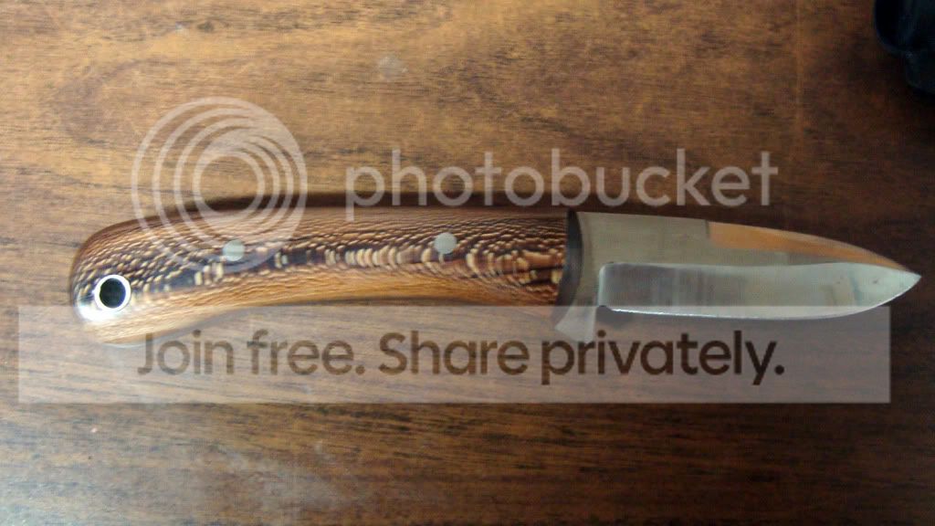

What's wrong with his pin alignment? It looks good to me. I see some from "professional" knifemakers that are all over the place. I prefer my thong tubes lower like his if I'll be using a lanyard.
@ Count

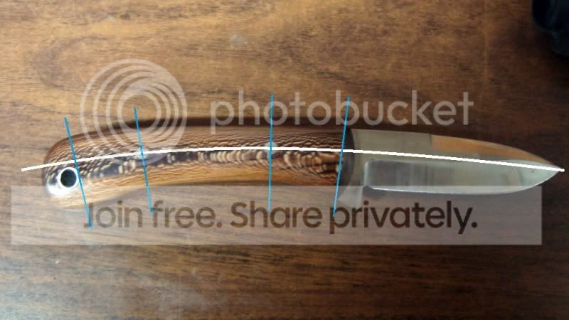

I don't really know, but something looks "off" to me- the "flow" everyone keeps talking about.
If you call it "front pin", "middle pin", "rear thong hole"
I have no problem with the thong hole being lower.
but when it is, the middle pin seems to be high in relation.
I try to use either a straight line, slightly high of centreline
or
have them all in a consistent curved arc radius that passes through all pins and makes sense with the blade.
If you eyeball an arc that passes through the blade centreline to the tip, front pin and thong hole, then the middle pin is not on that line.
I fiddled with the ellipse function in paint.
It's not doing what I want, but I hope it shows what I mean.
Pin alignment looks good to me... typical bushcrafter with the lanyard hole dropped. The spacing is even. Perhaps the wood grain is throwing you off, Count.
Huh
Now that Rick's arc ties into the point, it seems all in line,
but when I just look at the knife - the middle pin seems out of line to me.
The pin alignment looks good. The constant curve of the handle and pin alignment are obviously not consistent with the changing curvature of an ellipse.
Maybe not, but you should have seen the raggaty line I did freehand.
I do better with a pencil.
I think my eye just wants all three pins aligned somehow
There isn't much use in pick this one apart, all it was, was practice of a couple of things I wanted to try. Keep in mind that it came from a cut off, and the actual grind is really bad:o, that could be what is throwing your eye off count. There are a number of things on this that are not right that you may or may not see.
  1. grind is off center by about 1/64"
  2. right side swedge is shorter than the left
  3. pot marks in the epoxy on the file work
  4. neither of the sides have a nice even hollow grind
and the list goes on, I just wanted to show what a typical practice knife for me looks. I had also tried to do a hammon on it. I got a little bit, but it was very low and would have never shown once it was sharpened, so I just annealed it and redid the HT. Yes I do fool around with home HT on 1084 and so far have been getting reasonable results, no warps and only one piece has cracked, but so far anything that has passed on to a shop knife is holding a good edge. Most of my practice knives look really bad because I don't put any effort into the finish:o That is the main reason you don't see a makers mark on it, it is something that was never intended to leave my possession.
