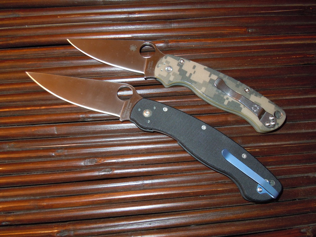

I carry Left pocket tip up. The Military is a sweet large knife that I would already own if it had the option of putting the clip in this position.
Just wondering if anyone knew if I sent one to Spyderco if they would drill holes for me where I want them?
Thanks,
John
I can't say for certain, but I'd bet against it. There is nothing there for the screws to anchor in but G-10, which really doesn't hold threads all that well.
Yab-
Youre the spydie expert, so Im glad you responded. I thought that the Military had full steel liners that the holes could go into and be tapped for screws.
darn it, Im not surprised.
It looks like the PM2 is all ready to go for the pocket clip to be moved to the position I like. When I get it.

Yep, the PM2 has 4 way clip option, but the Military only has partial, skeletonized nested liners. For many years, it only had one partial liner, but they added a second partial starting with the BG-42/CF Sprint, but even so they only extend about halfway down the handle.

I doubt it. On the plus side, if you have the tools and a little bit of know how, drilling the holes in the G10 and the liners (have to tapped/threaded) is a pretty simple job.
Except that there are no liners in the area where he wants the screws, just G-10 or carbon fiber. Unless he goes for the boat anchor...excuse me, the all titanium model. It would be pretty simple on that one.
There are ways to insert steel female threaded inserts into G10 so you can attach pocket clip screws. The Kershaw Echelon for example uses this technique.
You could also just send it to fellow forumite STR for a clip. It does not have to be the low rider variety if you prefer a more traditional clip. In my case he just screwed directly into the G10. He said if it ever strips send it back and he'll re-work with a metal backing to screw the threads into. He also said if I don't take the clip on and off too much it should last just as is. I tend to agree, I haven't had a problem with it yet. I've never taken the clip off and it's rock solid.
