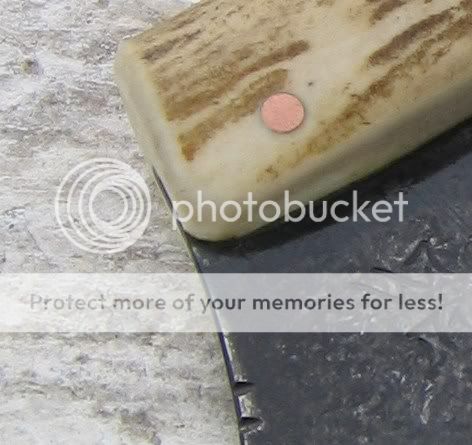

Here is one I made for a customer last year.... I forged it from a 1"x1"x4" block of O1 tool steel... I would use thin plate stock, normally... lol... it was more of "smithing challange" this way, but much more work...

magnussen, yours looks good with the antler and the copper rivets. if i make any more i might have to use some antler. is the antler only on one side?
Its hard to see... I didn't get a proper picture of it, but the tang extends about halfway through the center of the antler....
