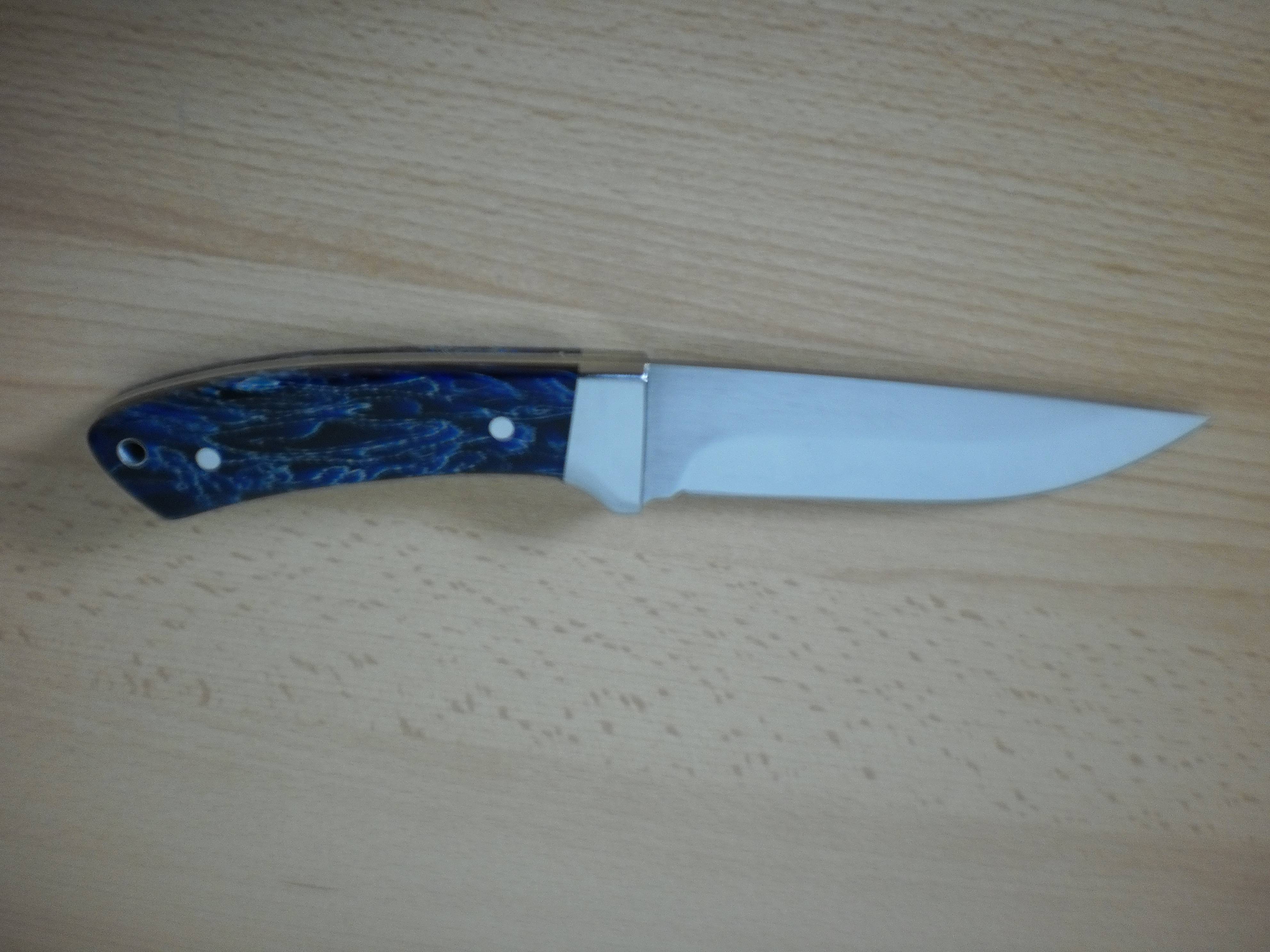

These three photos detail my procedure, tappered drill, 3mm pins with 3mm extra on both sides, hammer, shape. This one worked out great.
I think the press will make things more controllable and less violent.
Pablo

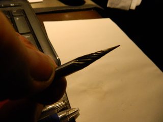

Chamfer your bolster holes with one of these. I purchased this from Texas knife supply I think. I run it in just enough to make a mark a little less than an eighth of a inch deep and hammer my pins in slowly with a 2 lb ball peen hammer. I have done hundreds this way. Larry
Peu I use your same way and work fine. The preparation of both holes and pins is important. Before assembling all, I clean the pins with a bit of sandpaper.
Pablo
I Think that you taper hole to deep and there was no material in pin to expand enough to fill all that space ...... You need shallow taper hole in bolster .Also I think that is imoprtant to use same material for bolster and pin....
This is my first knive make like that .You can not see gap with microscope ....The taper in the hole is about 3mm deep and width is 1mm more then hole . More than enough to hold :)
