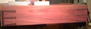

I once was using a Temple Builder's Paring chisel (blue paper steel) . It was a chisel grind , obviously , and at twenty degrees "inslusive" . I was using it on some crazy hard and tough Purple Heart wood and the edge was showing a little bit of dinging / rolling .
I increased the total angle to 22 degrees and the thing cut for days parring VERY LARGE dovetail joints with no further edge problems .
So that works out to 11 degrees per side in a pocket knife .
hmmmmm
Can't think of anything else I would do that would need a more obtuse edge . Outside of metal working .
Here is the chisel
Here are the joints by the by.
Lots of cross grain / end grain cutting . That is what beats on the edge.
