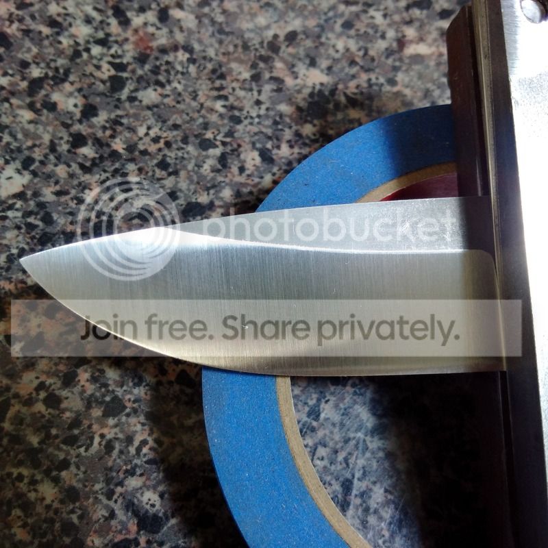

However despite my careful taping, when I was sanding the handles, somehow I got scratches near the ricasso and I got more scratches during the waterstone sharpening. Now I'm not really sure how to clean them up, Switch to a scotchbrite finish or hand sand again to cleanup...

this is the hand sanded finish at 320

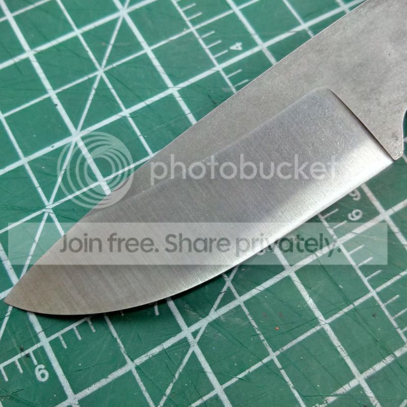

This is a clean 240 or 320 on CPM20CV, which is the same as M390.

Something else to think about. If you want a 400 grit finish, lay down a clean 600 grit then go back and pull a 400 grit finish. It looks a lot better like that.
