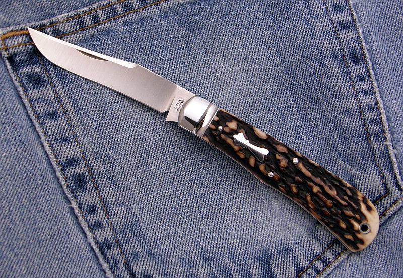

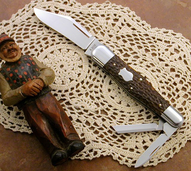

These two (both first knives drawn at Bade 2008 and Blade 2004) just gotta have bone handles ain't no two ways about it.;) Sometimes bone just adds that bit of warmth and nostalgia that no other material can do as well.
picture.php
picture.php
And that Pappy fellow sure has a bunch of nice stag:).
Bone just would not do for me on these two.
