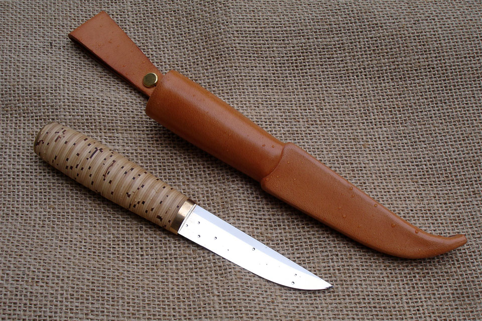

This is a one piece sheath I made 10 years ago.
A typical sheet of kydex is 0.060-0.090" thick. How thick is that leather?
About .09" or so. The bottom section has a wood or plastic liner, but the portion up around the handle that holds the knife under tension is just a thin layer.
The typical Ka-Bar style Bowie sheath is maybe 1/8" thick, but you don't need a ton of thick leather if you use rivets, liner or steel reinforcements, like on the bottom of the old US aviation survival knife.
But the thickness of the material is secondary to its rigidity and belt loop hardware. Kydex typically uses thick hardware.

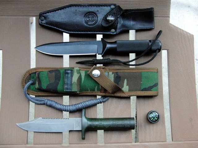

In the '80s I had a plastic handled Lifeknife. The camouflage sheath in this photo was just as pleasant to use as a similar leather sheath. This was likely due to the fact that is was made of actual Cordura with internal stiffeners and heavy nylon webbing.
Many of the "nylon" sheaths today are actually polyester with too-flexible webbing and inappropriate use of Fastec buckles and velcro. No wonder everyone hates them. Plus, why do we need MOLLE connectors???
Quality nylon sheaths are definitely possible, but I don't know who makes them anymore.
