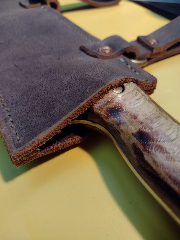

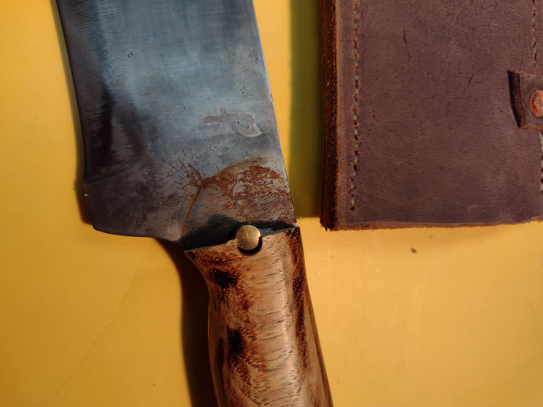

I have a seax I bought from a local maker. It has (had) a beautiful crosscut hickory handle. I left it outside on an extremely cold night. The next morning I saw that pieces of the handle had popped off the tang.
Anyone interested?

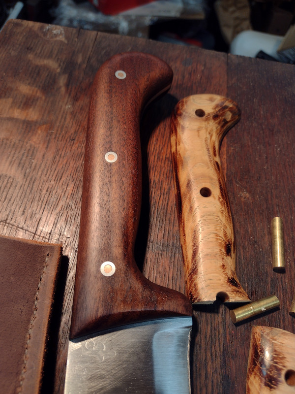

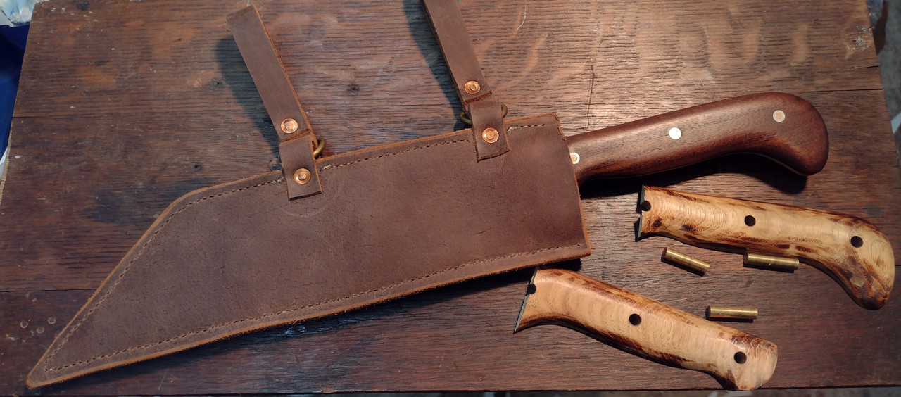

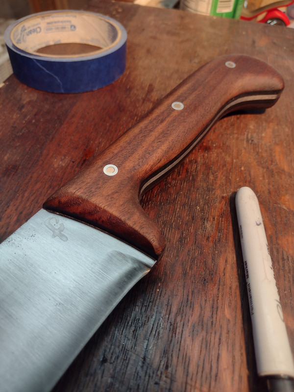

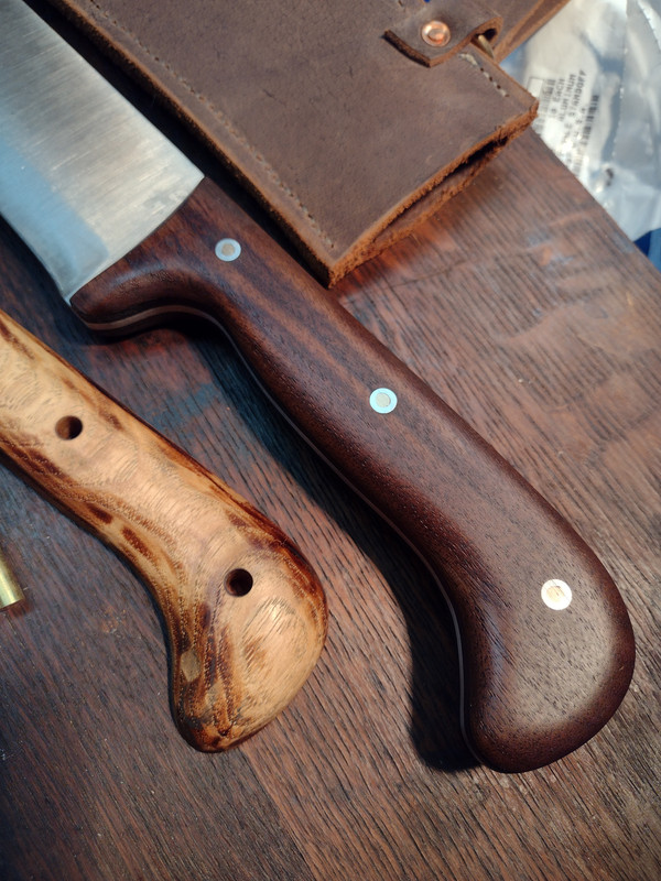

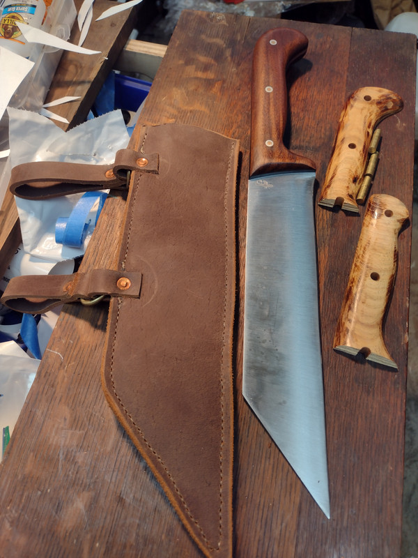

I don't know many details of the original maker, or the knife? I wanted to keep it looking still within their style. The owner gave me free reign to do whatever I felt it needed. I appreciate that, but I didn't really want to change it too much.

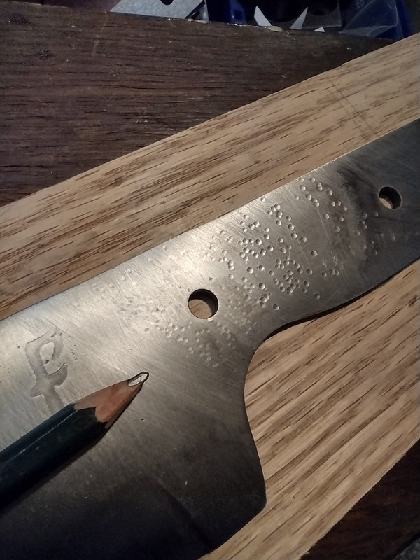

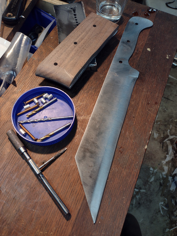

It was damaged from moisture. After removing the scales I noticed the blade had a good sized Warp. Took alot of dimples with my carbide hammer to straighten it out.

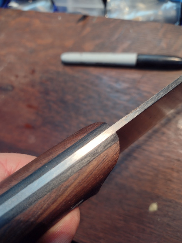

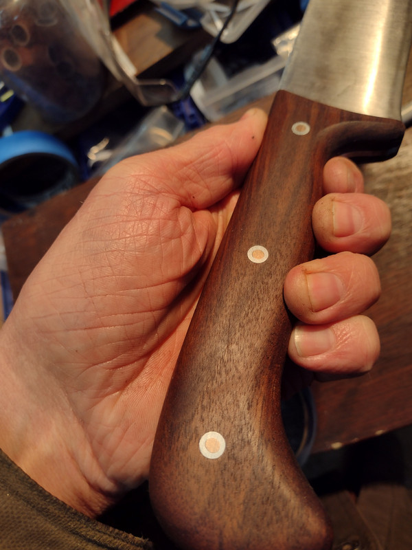

The owner likes wooden handles, and wanted something darker. I had some walnut in my shop that's been hanging around for over 20 years, looking for a home..I added some black Micarta liners for extra stability...I think these scales, and the handle turned out great.
I hope the owner gets to enjoy them for years to come. Thank you for letting me help you.
