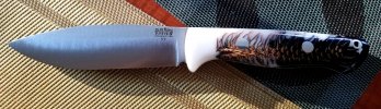

Of course it matters. I usually refer to that as the "height" or "tallness" of a blade.
A tall- I'm sorry, "wide" blade slices and digs through material easier, less "wedging it apart".
I know he's comparing grind lines, but it's the same concept; a "wider" blade will have more room for a taller grind and be better cutters.
Example, I picked up an UP Bravo over the standard bravo due to the wider blade:
Less abrupt grind that allows it to cut much better.
Like my fellas mentioned, it's less suitable for precision tasks (such as digging zip ties, cutting tags/wristbands, etc) than "thinner" blades such as traditionals, or like the CEO or something. Or batoning 🤪
