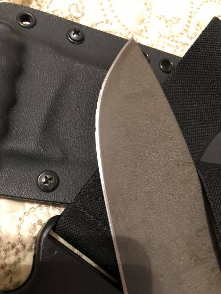

Looked through the stickys and couldn't/didn't find the answer. Just picked up a 2nd hand NMFSH with some edge damage, was wondering if Busse offered a sharpening/spa service and if so what would it cost me and what is the turn around time? Debating on who I will send it to to fix and would like some options. (My usual stuff goes to REK, just don't have the time to do it myself..)
I don't have it yet but here is what I'll be dealing with:
Thanks for any help/direction,
Greg
I stand to be corrected but as I understand it those chips and dings in the edge are all covered by the warranty. You send it in to the shop and they will sort it out.

A couple of minutes on a coarse stone would remove those little dents, which look to be about 0.3mm deep. or invest in a harbor freight 1 inch belt sander and run it across a course belt. 4-5 passes on each side at 20dps would likely remove those dings. That many passes on a coarse belt will not heat the edge either. finer belts heat the edge faster needing more care.
