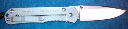

Yes, they will engrave on the handles. I don't think they will engrave the blade though. As far as the handles go, here is a pics of what I had CRK do for me. I cant remember the exact prices and they may have changed in the last couple of years anyways. On existing knives, your limited to reverse contrast ( blasted outside with shiney letters/symbols ) or blasted over like mine, with no color options. If you buy a new sebenza through crk, you can do colors. If you wanna know any particulars, post them and I will try and answer the best I can. Enjoy !

Mine was gone aprox. 3-4 weeks from the time I sent it to the time I got it back ( a sebenza bought straight through crk might be a little quicker, dont know what they stock ). I believe it was like $60 per line on the front and $32.50 on the back. There is a character limit on the back because they are fitting it between the screws obviously. Those are aprox. prices, but I believe pretty close. I cant remember if there was a set-up fee or not. I do know, once you come up with a design, its YOUR design and CRK will not do another without your permission. I have gotten emails by 2 different individuals wanting the NCIS engraving.
They will only do colors on new knives bought through them. The scales have to be perfectly dead flat. When they machine and use the solution/electric current to color them, it sometimes runs over, so they sand it flat by hand since its dead flat. Thats how you get the perfect lines at the edges of the colors. The scales that are not perfectly flat ( crk spec. flat ), are blasted over and used for regular plain sebenzas. Hence, no color can be added to them. But you can get reverse graphic. Which is blasted background with the shiney machining. I highly recommend the crk dvd, which shows all this. Matter of fact, maybe I will watch it tonight again, havent seen it in awhile :)

I paid 32.50 for my engraving. I simply had mine done when I sent it in for a spa treatment.

Some good information here. The only thing I'd add is to clarify the difference between "reverse silver contrast" and "silver contrast."
Silver Contrast - Blasted handle with silver engraving. This handle can't be refurbished.
Reverse Silver Contrast - Polished handle and grey blasted engraving. CRK can refurbish this type of handle.
