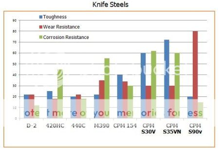

It is less tough than many other steels. But there are many variables. If the knife is designed for chopping, it can chop.
You can't use a chart like this to say "D2 is unsuitable for chopping."
I do not think that chart for comparison. D2 being a tool steel and the rest being stainless. However, as you can see from the chart, no matter what steel you get, there is always a compromise. A lot has to do with heat treat. I don't know what the source of this chart is, but in my experience D2 has performed far greater than S30V. Its all subjective. Talk to Ankerson about steel comparisons--he knows his (insert expletive here).
I think these charts are too simplistic. But I've never found a comprehensive chart.
Anyway, the basic point is, a knife is not just a piece of steel.
Out of interest, KOD, if the "toughness" test is the same for each subject, why shouldn't tool steel be compared to SS?
As a metallurgist I find that using tables as absolutes is not the best thing. Each steel has it's own properties and that's dependent on HT and type of edge . D2 BTW is sometimes called semi-stainless. It also has large carbides which produce a certain type of edge Some prefer that , some don't . My EDC test is to carry a folder for one year and cut what ever needs to be cut .Slow but far better than a quick test.
Well, I was just thinking since he was looking at a tool steel in the first place, it would be reasonable to assume he'd be interested in other tool steels. When I look at "choppers" I usually see them with either a tool steel or carbon steel. Particularly D2, O1, CPM-3v and 1095. Those steels are particularly valuable as they are high in impact resistance/toughness. The trade off of course is in edge retention and corrosion resistance.
