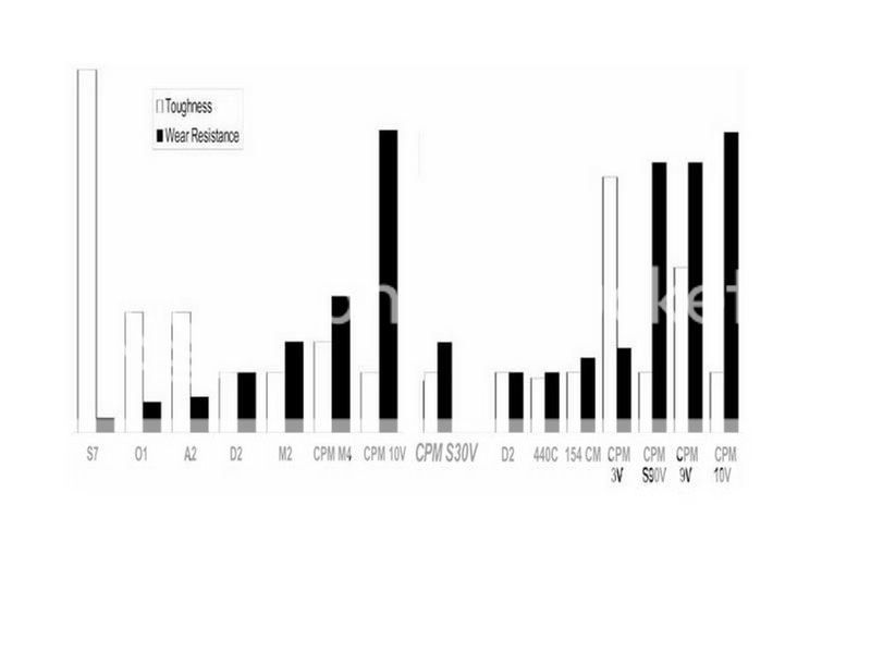

Guys ; please explain some thing to me ; as the chart shows that CPM 154 is tougher and more wear resistant than D2 ; wouldn't that make it superior to D2 ? I mean the increased toughness is obviously an advantage for chopping; yes ?

It does but if I remember correctly u where talking about 154cm before not cpm154 big difference:D
I am very sorry. I meant 154 CM. Some times l confuse it with CPM 154. Any way as l understand it ; 154 CM is definitely NOT a suitable choice for a large fixed blade knife for chopping. D2 is not the best for the job but certainly better than 154CM ( especially with a thick edge ) . Did l get it right ?
Post #21 has the comparison of 154cm & D2: practically identical toughness.
154cm is rarely made into a thick bladed chopper, usually thin bladed slicers. D2, on the other hand, is often used in thick bladed knives.
Don't put too much emphasis on those charts. Also, FWIW, I wouldn't choose A2 for a chopper either. I know there are a few made of it, and even some swords, but I personally wouldn't want a steel with more carbon than 1080 for a chopper.

I do not find D2, 154CM, and 440C as really different in terms of toughness. In terms of the discussion of toughness for use as a chopper, they are all more or less about the same and the differences in toughness is arguably going to translate more to the heat treatment and core design of the knife rather than which of those steels.
Not a huge difference in toughness between 154CM, 440C, and D2
The difference between D2 (and hence 154CM and 440C as well) versus many of the tool steels used on knives that will need to withstand impact
I would not pick D2, 154CM, or 440C for chopping or batoning wood personally, as I think all of those steels are not appropriate and may be unnecessarily hazardous given for under $100 a much more suitable knife (or for even less, an inexpensive axe) can be purchased and that's a small price relative to the costs of catastrophic failure. Having had a knife break on me, I'm obviously a little overcautious. YMMV.
