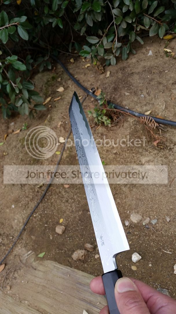

My cutting edge isn't Damascus, but I feel no difference in this with any of my other yanagi style knives.
Beautiful.
Damascus should be used as shown above^ not as an edge but as a "backbone". Its very strong and tough but generally doesn't have great edge retention. Again making it perfect for a backbone but using a much harder/keen steel core.
Isn't that how/why it was designed? Like the old Japanese traditionals? Very strong and tough yet malleable steel that can take a hell of a beating used for the majority of the blade but using a much harder steel for the edge/core to become razor sharp and stay sharp for a longer amount of time? (because a hard steel for the full blade would be more prone to breaking?)
