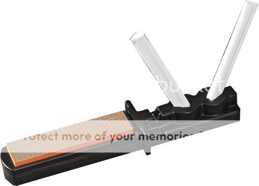

I bought this Smiths 3 in 1 way before I knew the sharpmaker existed. I think it was $15. The diamond plate works well for establishing the initial edge and the rods do the rest. I use it in conjunction with my trusty two sided stone I've had for many years. I use it as a step between the plate and rods. The stone is where most of the sharpening gets done.
Total investment was around $25 and handles most of my needs. Just don't use he carbide pull through on the Smiths unless you want to trash your edge. I actually removed the bits to kill any temptation.
