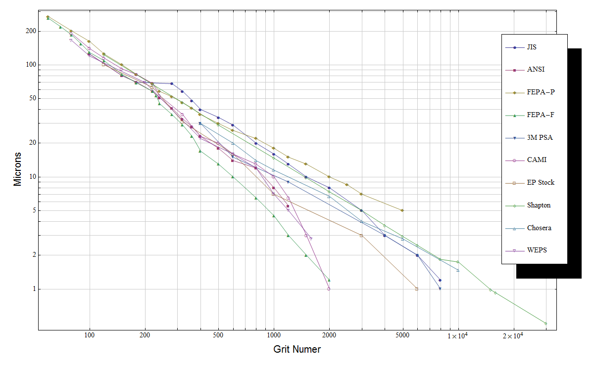

If you're curious about how "the same" grit number means different things for different standards, and even for different companies using the same standard, then it's worth looking at Komitadjie's Grand Unified Grit Chart. The thread for the Grand Unified Grit Chart is here (I think Komitadjie has the most recent version of the chart towards the end of the thread):
http://www.bladeforums.com/forums/showthread.php/856708-The-Grand-Unified-Grit-Chart
If you want a graphical version of the chart, Mr. Wizard made some nice plots. You can find that here, in this thread on knifeforums.com. This thread not only has a graph, but it also has some information about what the grit standards actually mean (and don't mean):
http://www.knifeforums.com/forums/showtopic.php?tid/904090/tp/7/
If you think that's useful, then please thank Komitadjie and Mr. Wizard! :)
