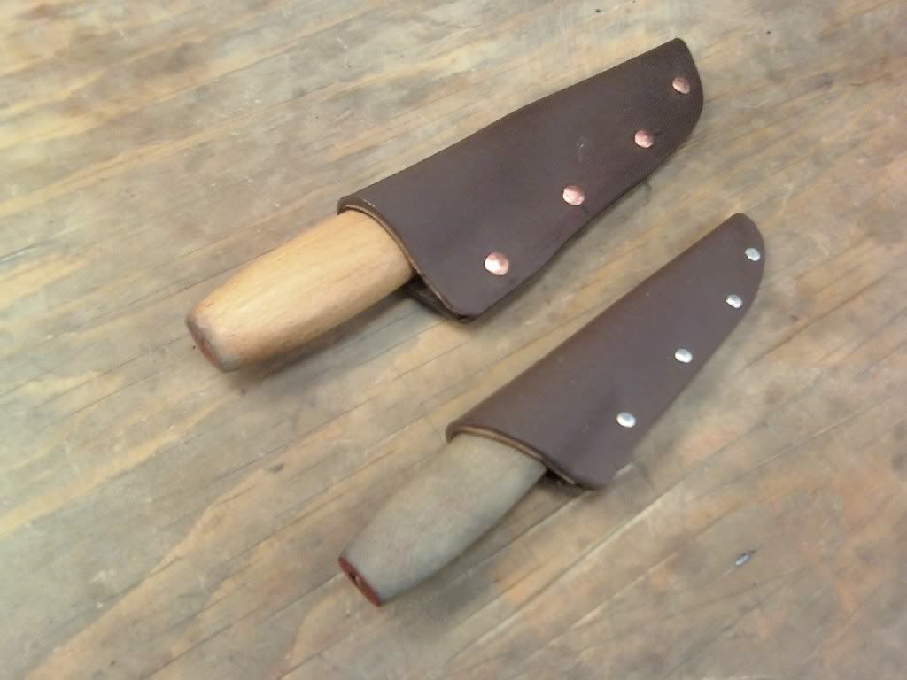

I just use scrap leather, some of it came from an old jacket I used to wear back in the mid/late 80s - it was just too groovy for me to ever wear again:) I don't do anything more fancy than rub some canning wax (paraffin) into the leather and melt it in with a hot air gun. Repeat a few times till it doesn't suck it up very well anymore. Shape to fit the inside of the sheath (the wax helps it hold its shape and makes it fairly rigid), smear the smooth outside with Goop, insert into sheath (making sure it'll accommodate the knife/handgun) and pack with foam or small rags till it dries. After it dries and if necessary, gently heat the sheath with a hot air gun if it has become too tight. It helps if the sheath has screws instead of rivets, you can spread it a bit to get a better fit and run the leather right out to the outside edge, but can be done either way. I've made a few from scratch this way and its a great way to EDC a carbon blade - they will not rust even at the hottest, sweatiest time of year. You can also get good retention on handle shapes that don't normally work well with Kydex, like puukkos, Mora classic, etc.
Not the prettiest, but they work great.
Have to add that I originally started doing this to my handguns years ago - discovered some other custom makers were already doing so but not widely known. Holster wear diminishes considerably, better rust resistance, you get smoother retention and a quiet draw - what's not to like? Adopted it for the TOPS knife mentioned above, and I'd swear it holds its edge longer for it - maybe the waxed leather keeps it from oxidizing along the edge, but I have my own ideas...
