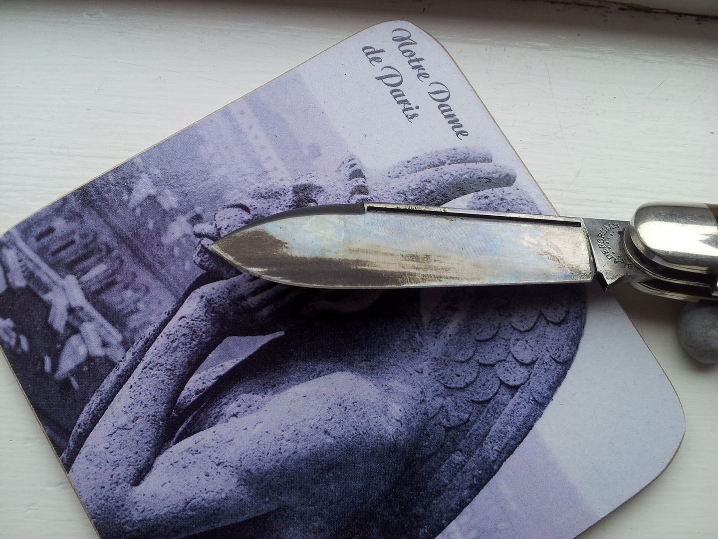

Before and after pictures of a Camillus 72 Frankenknife. Before cutting the leaves off a couple of dozen stalks of Rhubarb and about two minutes after cutting the leaves off a couple dozen stalks of Rhubarb.
