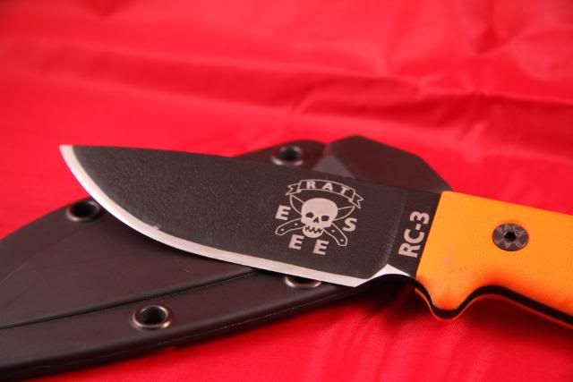

Is there a reason you sharpened the choil?
No not really;),
it doesn't look really nice but its a user for me and so i don't care:D.
I had taped the handles and the choil but still damaged the coating.
The choil is not big enough for my fingers so i will not use it.
