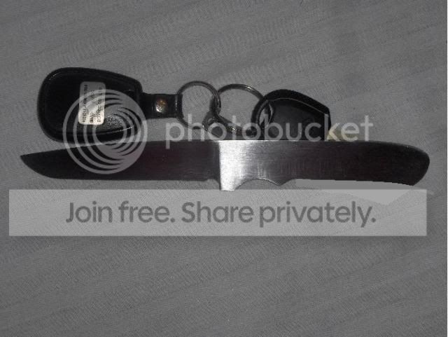

Does this handle look fat?

So, being a noob, I fell victim to Zero Edge Syndrome (ZES) while flat grinding my first blade. I had to correct by taking some width off the blade.
01.htm
Should I take some width off the handle as well? Also, any other opinions and suggestions are welcome.
Thanks,
Dave

I went across the room and down the hall and had my daughter scroll back and forth. It looks fine from there.
The finger notch, if reduced a little, would bring the blade/handle back into proportion. Right behind the choil.

I would reduce the hump in the back. Something kind of like this.
It would bring some of the balance back towards the middle.
Or if you you really like it the way it is, you can taper or drill multiple holes in the tang to rebalance it.
