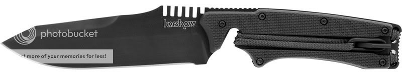

Does this make you worry?
Does anyone know how thick the blade is?
Too bad they turned it into a stick tang. As a full-tang, minus the cord-wrap "feature", it would be okay.
Alright, they could lose the thumb notches, too.
Well...maybe those crazy thumb notches are to facilitate a pinch grip on the blade for detail work.....maybe? But seems like they would be really rough on the thumb in "normal" thumb ramp use. Also maybe...maybe if they made the choil shallower and therefore the "lanyard hiding notch" shallower...them maybe it would be fairly serviceable. As is it looks pretty weak and uncomfortable.
Oh man, I can't wait to handle one of these! Such a completely frivolous design rarely comes along.
It's not that bad
With a little tweaking. There, I fixed it, you're welcome Kershaw.
nice one fishshooter, yup, it could look decent... but then the mall ninjas wouldnt buy it.
Say, fishshooter, that's oddly appealing. You fixed it really well. That actually looks usable.
That freaks me out. I bet I will see one of those in my neighbors hand someday :\
I don't like that knife.
But, I think that it is a Gavin Hawk design (http://www.g-hawkknives.com/index.html), or at the very least, inspired by his work. And I have to say, that Gavin's designs are pretty brilliant, and he has a very definite style, I recognized this knife as being of that design lineage immediately.

Interesting link to the Hawk stuff. Still, I don't like the look of any of that either.
I don't have an engineering type mind and I marvel at the brilliance of engineers. However, over engineering and building a different kind of mouse trap exclusively for the hell of making something complicated looking, just because that plays on your strengths and can be foisted on to a week public is something that has no appeal to me. That bit of piano wire made the Buck 110 a legend, nothing else. In fact the knife itself is quite crap. That simple solution made history. And what of Walker and the locking liner, a simple elegant solution. But there's nothing here for me to buy into.
I find everything behind the cutting edge on this knife objectionable -
A step in a truly useful direction would be to turn that cut out into a shackle wrench to punt at mariners. Even then there's some fairly obvious reasons why you'd do that to the arse end and not have it where it is.

I've always been skeptical about those "one-trick-knives": either a feature is great, and then it deserves to be applied to all knives from the brand, either it is useless and then no need to make a knife out of it.
It's a sick joke from Kershaw. The cutout looks like the knife is giving the potential buyer and/or the owner the middle finger. The way companies are now making crap like this, it wouldn't surprise me to find out it was an inside joke.
I could scarcely believe it when I went to the Kershaw booth at SHOT this year...it was like someone had junk-punched their design team or something! The only new pieces that they unveiled at the show were the Zing and Packrat (which had been floating around for a while at that point, so they weren't really "new") and THAT abomination. How that got past the concept stage is WAY beyond me. :barf:
Most of their new designs were unveiled at BLADE show this year, and there was some pretty cool stuff. I don't like to be referred to as anybody's "fanboy", but you have to look at Kershaw as a brand - they like to try new things. Composite steel blades weren't a new idea (Michael Walker did it a while ago), but Kershaw has brought that concept into mass production. Is it a viable idea? That's up to perosnal interpretation, but at least they're trying to innnovate. They've also made a lot of complex CNC machined products with Titanium handles at affordable prices, and their quality is very good. Their newly unveiled Speedform Folder won an award at blade and features a new framelock that is cut at a bias so that it can;t be unsprung and doesn't need a Hinderer lockbar stabilizer.
As for the design that we are currently discussing - this design was actually created by Grant and Gavin Hawk. As far as I know, the cutaway in the handle is only there to accomodate stowage of the wrist lanyard. You may not like the idea, but they're just trying to bring a little innovation to the concept of a fixed blade. Again, this is all subject to personal opinion.
No, it's not a Busse. But as to the narrowness of the tang where the cutout is, apparently no one here remebers the concept of a stick tang. Stick tang construction is used in many knives such as the venerable KA-Bar Marine Fighting knife, many Randalls, the Buck 119 (and others), and Marbles style knives. Stick tangs are rarely more than 3/8" wide, and are often much narrower. These knives may not be the strongest pieces out there, but many of them have held up to quite a bit of abuse.
My point? No, this knife is not a Busse. If you want a knife that sacrifices fine work cutting ability but allow you to use it as a crowbar, buy a Busse. This knife is a different piece, but I think you'd be surprised how well it would hold up to regular use. Would it make a prefect survival knife? Perhaps not, but I have not tested one myself.
