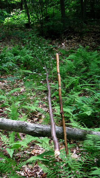

First up, pole selection. This one looked fairly straight,
After chopping it down, I dragged it over to a nearby workbench.
Chop off the top.

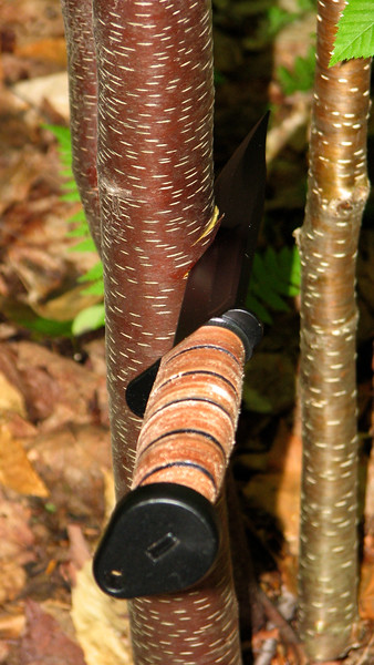

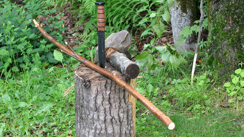

Next up clean up the bottom chopped end. I should note here. I had a catastrophic failure at this stage. The stick I was using as my baton broke. Oh My! I grabbed another stick and moved on.

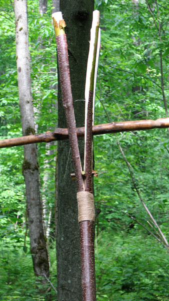

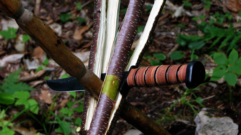

Tap the knife into the end twice to form a cross and split it into four prongs.
It should look something like this. For right now, just go down 8"-10"
Y'all carry twine in your packs right?

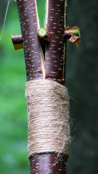

Measure down approximately 16"-18" inches. I just go from the back of my elbow to my finger tips. And wrap roughly 2"-3" inches of twine snugly around the pole. This will keep the splits from continuing to split past this point. Then take the knife and finish splitting the prongs down to the wrapping.
Hint #1,
It is easier to turn the pole to wind the twine on, rather than try and wrap the twine around the pole. I find for most of my uses. A length of twine wrapped from thumb to elbow six times works well. Any longer and it gets tough to keep untangled.

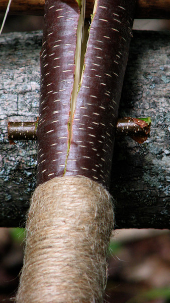

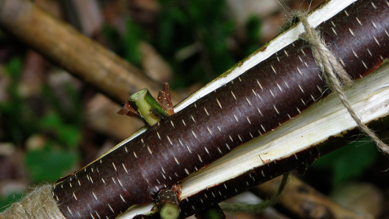

Next, grab one of those branches from top part and make yourself two little pegs. They should be just a little wider than the pole.

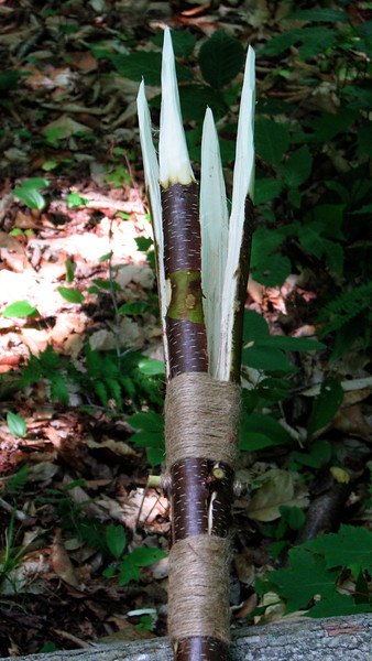

Work one peg down into each split. Get them as close as you can to the wrapping. You don't have to get them all the way. So don't lose your mind.
Hint #2,
Take the walking stick and roll it down into the splits. It will make working the pegs down much easier. Alternate back and forth a little bit at a time.
Here is what they look like with both in place,

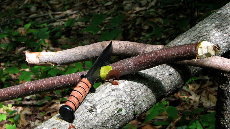

Now that all the risky stuff is done. It's time to sharpen the points.
Hint #3,
If you can find a downed log or tree. Take your hiking stick or any stick, and drive it in the ground right behind the downed tree. Then take the spear and slide it up snug to the stick. This creates a primitive shaving bench. Now you can take your Dog's Head with both hands and use it like a drawshave. This speeds up the point carving process quite a bit.
No need to get too crazy with the points, Personally, I like Caveman Tanto myself.

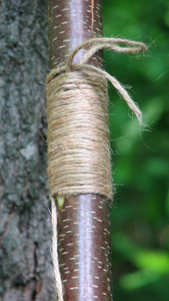

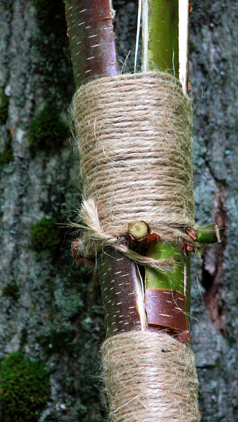

Almost done, some folks just wrap up to the pegs and tie them off to hold them down. I like to wrap down to them from above. This gives me the ability to adjust the spacing of the spears. I just start on one of the spears with a Clove Hitch. Leaving a tail that drops past the pegs.
Then I just wind my way down to the pegs. Setting the spacing at the start. Wrapping the lose end in as I go.
When I reach the pegs, I tie off to the top one, boat cleat style. And then tie the lose end from the clove hitch to this end, done!

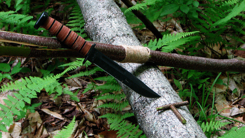

Finished product,
One last shot with the Dog's Head in it for well deserved photo credit,
This knife just plain rocks!

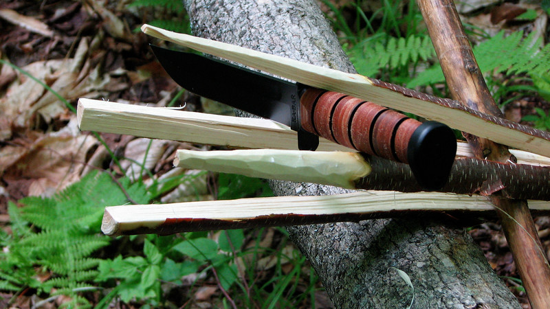

Nothing too tough here today. But a wilderness necessity never the less.

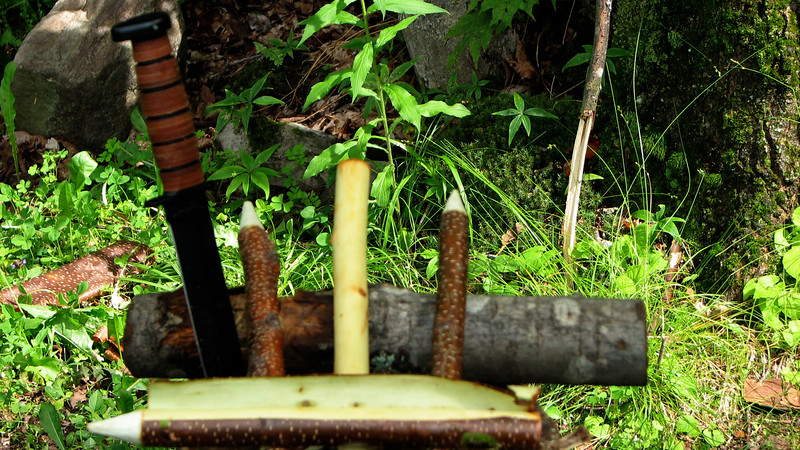

I took the top from the tri-pod pole. And set out to make some tent/tarp pegs.
Tarp pegs are kind of boring. No one pays much attention to them. That is, until that T-Storm rolls through at 02:00. If your tarp or tent is poorly anchored, suddenly they become extremely important.

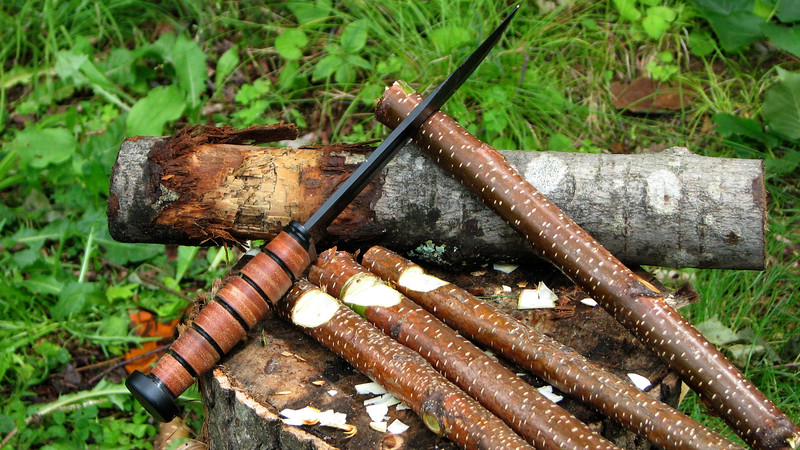

Here are four cut to length. These are exactly one KA-BAR length. (KBL for future reference). I just lightly batoned through the top to acquire four pegs of the same length.

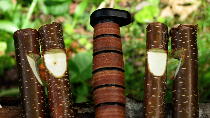

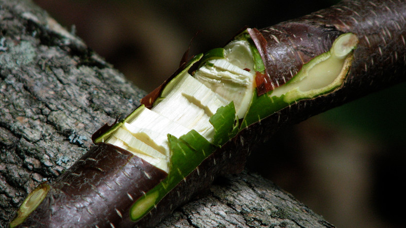

Next up the rope notch. I always cut the rope notch first. This is the only real spot prone to failure. So why do all the rest first. Just to have the notch blow out and ruin you peg. Leave a little room on top for some support. I used one blade width.
Just baton in about a third of the diameter of the peg, then shave down to the bottom of the cut. ***Never baton with a KA-BAR, it will explode***

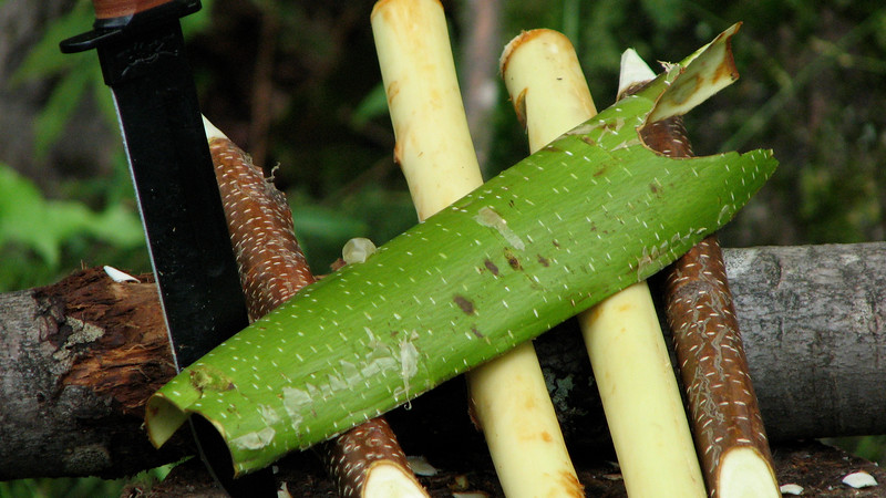

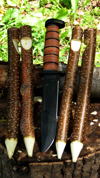

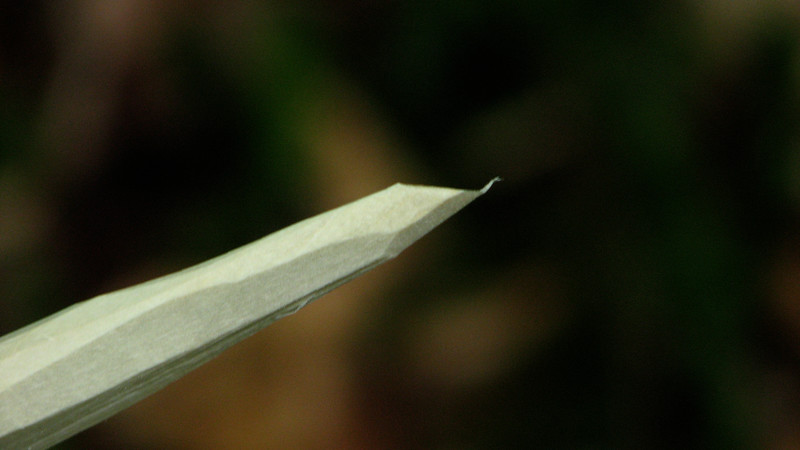

OK, with the risky stuff out of the way. Let's carve some points. Not too sharp or they will just fold or dull. Think big crayon, or carpenter's pencil. I like to use a reverse grip for this. Hold your knife in your strong hand with the blade facing your elbow, tip up. Then trim/pull the peg across your chest with your other hand.
Peeling the bark. This step is optional. But I usually do it, as I try and reuse my pegs. Peeling the bark off, keeps them from rotting prematurely. I just ran the tip of the Dog's Head down the length of the peg and peeled from there. I peel them last, because they are quite slippery at this stage. Better to leave the bark on for grip until everything else is done.
This green stuff, the inner bark or cambium layer, is Secret Squirrel Stuff, save it.
Here is the finished product. Tent/Tarp Pegs. Boring, but necessary. Once they dry out a tad, I will most likely fire harden the tips. It makes a world of difference.

Dude, I know you're downplaying this but I've never made these pegs, I can now. As long as its not tomorrow... Short term memory loss is a bitch. Great info here and very entertaining! Thanks again!
The only problems I've ever had with a tent stake like those, is that sometimes they can split on you after pounding them a bit. To help with that, you can "chamfer" the edges on the top (just make it a rounded bevel, instead of a 90 degree between cut and the wood), and it makes the tops not mushroom when hammering them, and then also resists splitting.
But agreed. I love seeing all this fun stuff. Keep up the good work :).
