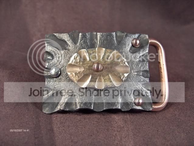

Thanks! The belt buckle was the first project that I used my domed pins on. After some practice I can get a much cleaner dome now.
