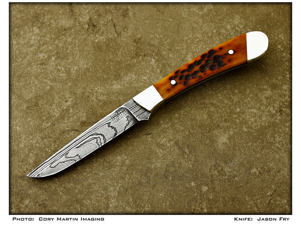

I am fixing to build a couple of double bolstered hunters. Trying to decide whether to taper the tang or not, and to dovetail the bolsters or not. Un-tapered makes for the easiest fitup, whether dovetailed or not, but I'm having a hard time figuring out the compensations for the angles if I both dovetail and taper. Any suggestions? I'm on 3/16 stock, so I'd really rather taper if I can figure the dovetail thing out. Putting stag on one and mammoth on the other, so there's not much wiggle room for fitup mistakes.

Lol, that's why I'm doing two. One for practice, the other for ivory. I hope to have at least one of these, maybe both, at the ICCE show in September when I'm up for voting membership. I do dovetailed bolsters and tapered tangs all the time, but have never tried the double bolstered dovetailed.

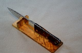

Jason, What is a "double bolster"? Do you have a photo of one? Thanks, Larry PS here is my dovetailed bolster on a tapered tang blade. I taper to the front of the bolsters, LL
I mean both front and back bolsters like this one.
I realized after I asked the question that one of these will need to be square fit, not dovetailed. I want to get the ivory one scrimshawed, and would prefer the straight bolster joint vs. the curved one like you get with dovetails.
