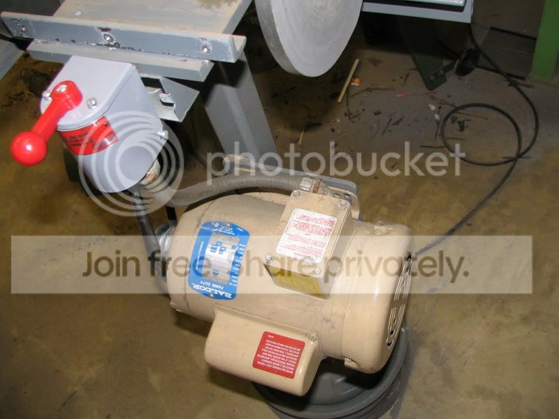

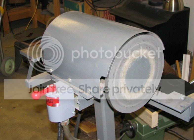

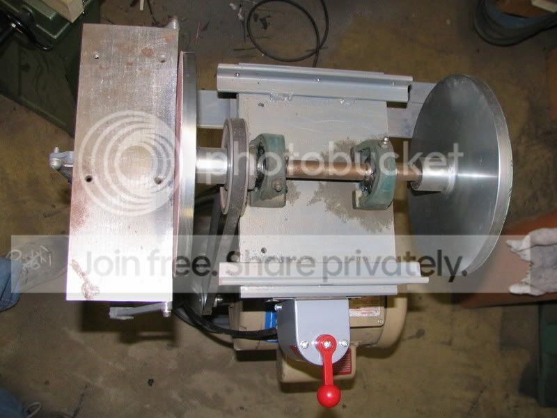

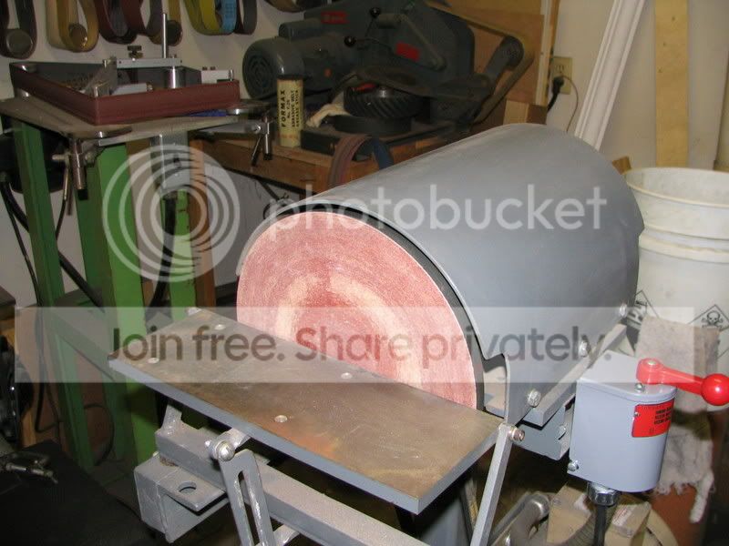

Here's some photos of my double disc. Just to give you some ideas.

Wow! Thanks for all the input, and especially the pics, Charles!
