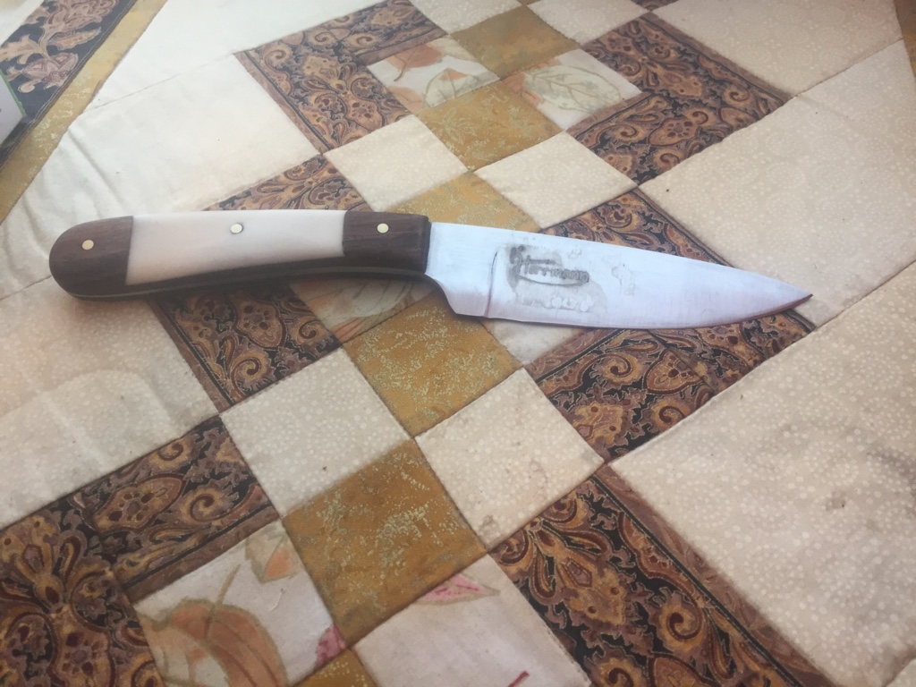

Ok, so I finally got my TSP and used it per Mr. Niro's suggestion in this thread: http://www.bladeforums.com/forums/showthread.php/1432676-Bone-Handle-Tutorial-Please?p=16511975#post16511975
The bone cleaned up to a lovely ivory color, and is very nice (but the shop reeks of bone powder for days after working it :barf:). My current dilemma is that after grinding the bone flat enough for scales, most of it is a bit too thin to make a good handle. I suppose I could just get some liners to thicken it up a bit, but I have never used the stuff before and I prefer natural materials for my knives.
So, I have this idea to make wooden scales with dovetailed bone inserts. This is probably pushing my skills quite a bit, but I kinda want to try just to see if I can pull it off. The tools at my disposal are: Esteem belt grinder/w flat platen, drill press, table saw, scroll saw, pencil grinder/w assorted bits and burrs, files, sand paper, and many other hand tools. Basically most of a mid level knifemakers shop. Notably what I don't have that I wish I did for this project is a mill of some sort. The questions that I have now are: Is this reasonably possible with the tools I have? Any suggestions for cutting and fitting the dove tails?
Have any of you tried this sort of handle design? Any of you have any tips, suggestions or preferred methods for doing this?
I think you could do it if you basically take a handle scale, cut it in half length wise, use a scroll saw & files to carve out the area for the insert (which would be right in the middle of the handle, then grind the edges at an angle so the outer scale material has an undercut bevel (larger surface area on top of the scale, less surface on bottom), and the insert has a bevel that has less surface area on top and more surface area on bottom, then you could theoretically slide the insert into the scale and epoxy it all in place. Does that make any sense? Just to note - this is just an idea of how it could work, I've never actually done this before.
I think I'm following, but a scroll saw stinks at a precision cut when I'm the one running it. I am actually thinking of cutting the female side of the dovetail with a table saw set on an angle and cleaning it up with hand files or sandpaper, and the male side I should be able to do on my belt grinder by setting my angle on the work rest. I also should note that I'm planning on using three pins in the handle, with one in the center of the dovetail and g-flex epoxy for assembly.

Well, not sure if this turned out better or worse than I'd hoped. I love the overall look, but I fought to get the fit right. It still turned out pretty good, but I think routering the dovetails is better than the method the method I ended up using (grind recess with 2x72 and undercut with a file).
I'm beginning to wonder if I'm making it unnecessarily difficult for myself. Do I need dovetail the insets or is the epoxy and pin enough? Does the dovetail add enough visual interest to merit keeping it even if it's unnecessary?

Custom Knives are scrutinized for details and the addition of the dovetail as pains taking as it may be shows higher level of craftsmanship. Now that you have completed one the next will be easier and you will probably acquire the tooling to make it go faster with better detail. Looks good keep it up.

I think it turned out pretty good, especially for your first try!

I do believe your handle progress is great ! A lot of the "extra" things that can be found on knives are specialty items. Usually they add to the knife and are appreciated by viewers.

Looks like a lot of work to get the bone inset exactly. I would suggest do your 45 degree mating angles on all 3 separate pieces, scales a bit over sized, mate them and epoxy them to a liner. Same material as the non-bone if you want it to match, contrasting if not. If you used white g10/micarta as the inset (or end caps) and liner it might look interesting . You did a great job from what I can see, but it had to be time intensive. Hope this helps.
