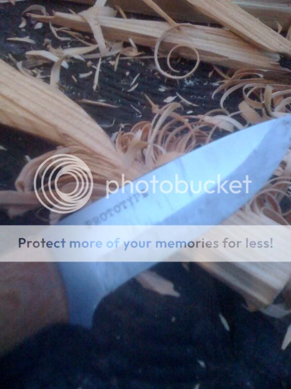

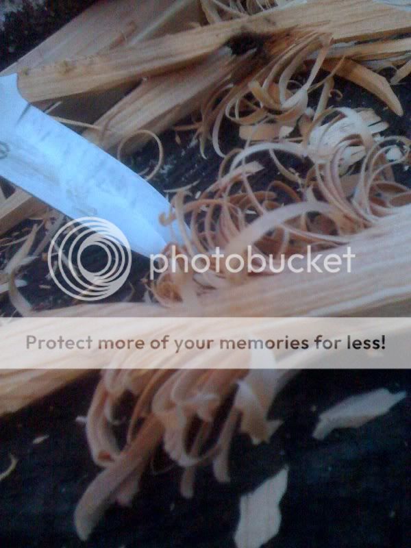

Cutting- There is no question this knife was made to cut. I carved on Juniper, Fir, Oak, Brazilian Cherry, Ash and Pine, this knife made deep and even slices into all of the woods. Brazilian Cherry is an incredibly hard wood, I was interested to see how it would handle it, but the blade didnt want to slow down on its way through the wood. Notching was another great benefit with this grind, as I was able to make very controlled and precise cuts into any one of the woods tested. I took a piece of Fir about ¾ thick and made a cut through in one slice at a very steep angle, with little hesitation of the blade.
Fire starting- Along the same lines as cutting, this knife made short work of fuzz sticks. The knife has an incredibly sharp 90 degree edge on the top of the spine, and getting a spark on a metal match was no issue. I actually took the top of the spine to a piece of fir and was able to make enough fuzz without ever using the blades sharpened edge, to start a fire with a metal match.

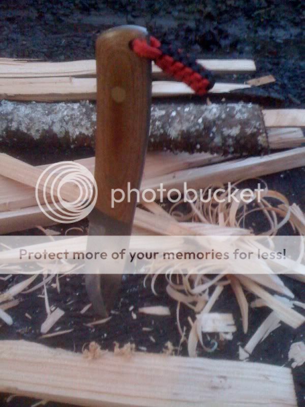

Batonning- I was able to baton through wood fairly well, though, the blade is approximately .125 thickness at the top of the spine. There is an obvious tradeoff with going thicker, you can split a little better without the blade wedging too much, but you can take away some of the knifes ability to slice as well as it does. I would maybe consider going up to .135, but I am not sure I would want to or not.

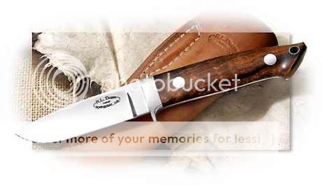

I have placed an order for one of these beautiful knives, the one I ordered will have the Dozier Loveless Style Drop Point Hunter style handle with Desert Ironwood Scales like the one below, minus the hilt.
