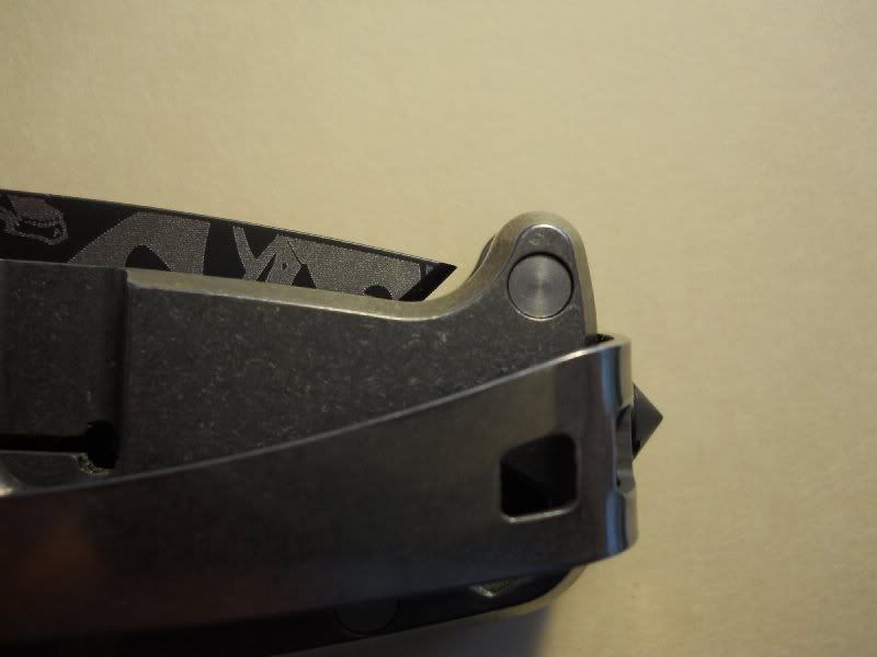

Oh my !
Unfortunately, the blade to handle gap when closed is pretty large on mine...

So, just for clarification, you are going to manufacture a smaller diameter stop pin that will still fit in the preexisting holes in the scale, liner and ti (and looks to be a press fit) without affecting the the lockup on the blade? Maybe with some stepped construction on the stop pin?

Personally, I think the blade is short enough without having to grind off 1/4" or more of the tip just to get it to nest safely in the handle.
So, does the stop pin actually make contact with the choil when closed?? If thats the case, I guess I could go get a small round file to deepen the choil...of course that is dependant on how much clearance there is between the blade edge and the backspacer...

I am curious. If you change the size of the stop pin want that in turn mess up the ball detent? Mine sticks out a little but I did not even notice it until I read this post. I would prefer it sit all the way down but not if it will mess up other functions of the knife. Outside of this the knife is pretty damn amazing.
