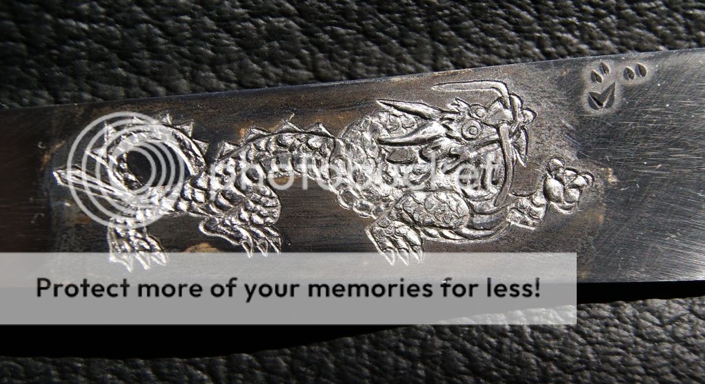

I just finished engraving this Kiridashi for James Bieler (Bubba-San Forge). This is my second time engraving metal. This Kiridashi is made from 1,000,000 layers of Tamahagane steel. Because of the high carbon content, there is some rust starting. Next time I'll know to keep some oil on the blade. James will polish this out and etch the blade to bring out the "wave" pattern in the steel. I did this with a Foredom Micro-motor. To see a WIP on this, go to http://www.knifecarver.wordpress.com. Comments Please!

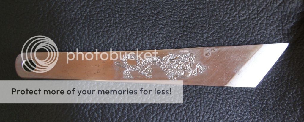

Updated Photo - Just got this picture of the Kiridashi. Bubba-san (James Bieler) sent me this picture of the Tamahagane Kiridashi. He still wants to polish out some marks made by the polishing stones & place my initials in small Kanji beneath dragon. James made the lanyard from Japanese ito cord, even the red string is from Japan. He is very traditional! Then the Kiridashi needs a traditional Japanese presentation box, the kind that is signed and usually made from empress wood. They are dovetailed with very small cuts and lined with bright silk.

Dragon Horimono on a Japanese Kiridashi
Knifemaker – James Bieler (Bubba-san Forge)
Engraver – Catherine DeFelice (Knifecarver)
Knives like this are sometimes given as wedding gifts to the bride, or any family event they want to commemorate. Knives were given to Japanese ladies for self defense, and for taking ones life. Usually a kaiken or Tanto was used for this purpose. Receiving one with a Dragon horimono was for good luck . A birth would be a typical event, but there are many. It would be similar to getting a pair of bronzed baby shoes at baby shower, or something along those lines.
Very nice work!! Love to hear that tidbit of Japanese tradition and culture, and can't wait to see the presentation box.

Thank you, Conner & Johnny M. for the nice comments! I'll keep after James to send more photos.
Thank you, too Richard! I've engraved 440 steel, which is around 57 rc. If you have a scrap piece you could send me, about the size of a quarter, I would be able to give you an answer. My contact info is in my profile.
