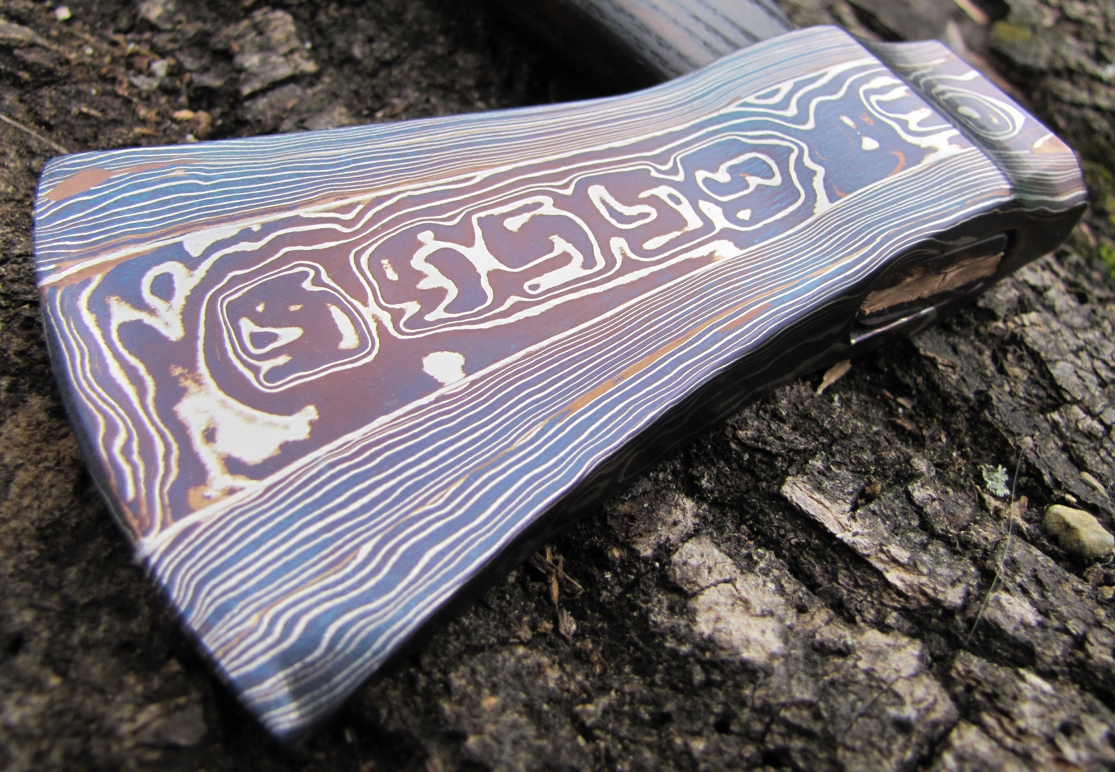

Ah, thanks for the info. But how do they get these colors? How does it work?
I have a bar of it that I have been saving for the right knife. The bars are composed of ball bearings all forge welded together.
Hi . This is top class work indeedMy guess it is made by using nickel coated balls or rods and the colors are just the tempering oxides ..
As the nickel dont get them you may create the beautiful coloring and contrast using various temperatures

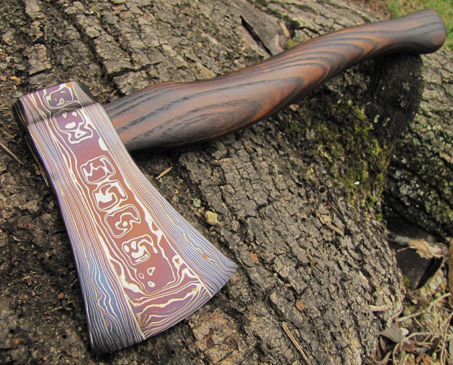

The coat is very delicate . Check this axe made by my friend and me . We used tempering colors with nickel and some kind of varnish coating to conserve the color
There surely will be some chemical solution to obtain different or more resistant color. Bye Petr
I'm curious if you have any information as to the actual properties of the stuff like wear resistance testing (maybe TCC testing on cardboard? Or similar) or toughness testing (maybe c notch? Or anything really), or even just a general range the stuff is usually hardened to (Rockwell)? If not I understand but I'd be very interested, although I'm aware it's purely used for aesthetic reasons, I'd still like to know.I know this is an older thread, but seeing that it's been revived, as mentioned in a couple of previous posts the damascus is colored using nitre blueing salts, and different colors can be achieved with different times and temps. Some use heat as well, but it seems that nitre bluing is the most common technique used for these highly priced art knives. Apparently is doesn't wear that well so it is mostly used for looks on knives that won't really be used. Also, it can lower the steel's hardness a bit, but if the smith/maker knows what he or she is doing it can be be minimal, I have read maybe 1-2 points lower RC. But yea, it's purely aesthetic.
edit: here's a cool example by Reese Weiland of different color shades you can get with nitre blueing salts.
