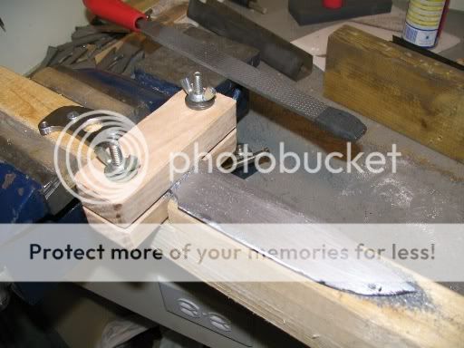

I think the draw filing jig was a piece of angle iron. Drill and tap six or eight holes maybe 1/4" on one end. Clamp the blade tang on the opposite end with scrap leather padding it against the angle iron. Then screw a few bolts up through the angle iron to support the blade from springing or flexing while you work on it. The other 'L' of the angle iron can be held in a regular bench vise. Thanks to Terry Primos for a simple hugely helpful jig.
Best of luck with the project, Craig
I do a lot of draw filing as I have a very primitive work space, and I use a 2x4 cut to the basic shape of the blade and clamped to the work bench to support it so it does not bend and to clamp the blade I use a "C" clamp with a smaller piece of wood between it and the blade and tighten it down, so far I have not had any problems with the blade bending or sliding as I am filing.
Tim
I've got a basic 4" bench vise on my workbench. I took one of those "suction cup" mount vises that has a ball joint so you can move the vise head around, and broke the bottom half off of the ball with my forging hammer.
Now I tighten the ball into my regular bench vise, and... Voila! any angle I need between the two vises! This gives me incredible versatility in securing the blade at any angle and / oir height I may need.
I use a piece of flat stock (1084, as that's what I happened to have on hand) under the workpiece to help make sure it is sufficiently stiff for draw filing.
I do the same as others for draw filing and hand sanding. I have a 2" wide piece of mild steel that I have bolted through my bench, then I c-clamp the tang to that and draw file the blade that way.

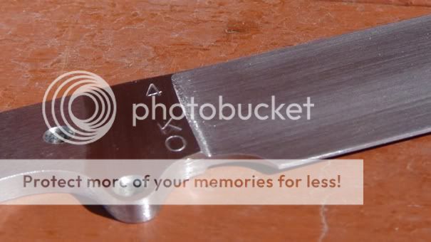

A piece of 3" x 5" x 3/16" square tubing with a slot on both sides plasma-cut out, and a $4 visegrip:
Very interesting thread!
...and a closeup of the result:
Holly crap! You did that without a belt sander? Just hand filing? Oh well... then I guess you are the MAN who is going to help me out here. Congrats btw!

David, you need to change yours for one like the other guys have. Yours is dangerous from the standpoint that you or someone could trip and fall into the blade, or at least you could slice a finger open, or worse. The type the other guys have, even the 2 x 4 has wood or metal completly under the whole blade, including the tip, and it would be hard to get stabbed to death falling on it. Also, if you ever have children in your shop, even once a year, someone could walk by and poke an eye out.
This is called hand sanding...its almost exactly the same process as draw filing except you can push AND pull and apply as much force as you want up to about 400 grit. After that, you should be going from ricasso to tip only to avoid fish-hooks in your finish. Hand sanding can be relaxing or the worst possible process on earth depending on your mood, the steel, and what tunes you have on in the background!
I have some slightly dull 180 grit belts on hand, would a piece of that work for sanding it out?
Agreed. I never leave blades like that, the pic was taken while I was working on it. I only overhang the tip on rare occasions, and usually support the whole blade to avoid flex anyways. Thanks for the heads-up, though!
I have acted this one out... Decided to do a quick shop-vac around a blade that was clamped with blade totally exposed. Went to get at some crap under the table and almost knocked myself out slamming my forehead into the tip of the blade (this was post-HT:eek:) I have now confirmed that the RC of my head is woefully inadequate to that of a knife. I was so dazed that when I first realized what must have happened I was concerned that I might have damaged the tip of the knife! Then the blood brought my attention back to reality. I was VERY lucky not to have slammed an eye into the blade. Guess this is the only time I can think of that being a short bastard has ever got me anything more than grief:D And keep in mind, I had always unclamped the blade when done with sanding. This is just one of those things that can happen with the wrong setup regardless of how careful you think you are:o
P.S. If you want a really simple setup, just cut out a 2X4 in the shape of a wiener and C-clamp it to your workbench, then C-clamp the blade to that. (add protection as necessary!:p)
