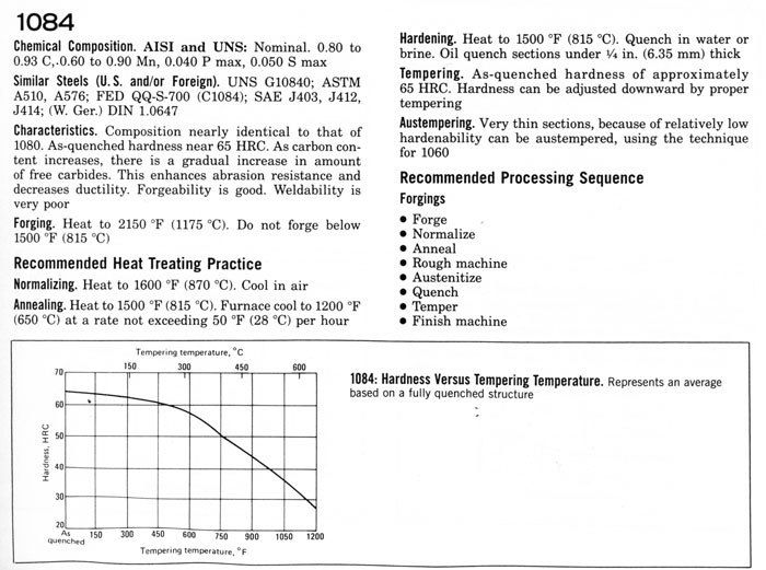

I have a client that has ordered a Damascus throwing knife. I made it out of 1084 and 15n20. I have not hardened it yet and would like to know the best temperature to draw back after harden for a throwing knife. I really want it where it wont break. Will have an edge just not sharp. Any Ideas what it should be? Thanks

The temperature is what I am hunting for. I dont have a Rockwell tester and it will not have enough of an edge to do a roll test. It will be about 1/4 inch think and 15 inches long. That is what the client wants but I think it will probably end up being about .200. I want it to be tough and springy. I think I may put a small piece of the same steel in treat it the same way the test the heck out of it. Any one out there made one that has held up?
Yes, I have my charts out now, and Rc50 would be about 750°F for 1084. Rc55 would be 650°. At 600° you are in the Rc 57-58 range. 15N20 has a higher range, with Rc55-56 at 700°.
So, 700°F to 725°F sounds like a good temper for a throwing knife in a 1084/15N20 mix.

Stacy and Andy, sounds like it will be 713 degrees for 2 hrs. Then I will test the extra piece I put in there with it.

Thanks Karl. Copied that chart and in my files. Will print out and post in my shop.
