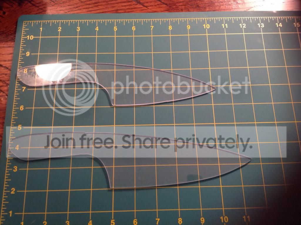

I ran in to town after church and got some trace paper and a cutting mat( $20). Sketched these out and cut them on acrylic so I could feel them out. They feel pretty good. Any suggestions on the design that would make them more functional? I know that a lot of it is personal preference but I'm sure there are some basics that shouldn't be ignored.

Looking good there Rookie. The only thing I might suggest is to make your handles a touch longer. According to your photo you would only have three inches to hang onto before the last inch of handle starts falling away. See what adding an inch to the handle looks like to you or how it feels in your hand when you cut out the template. The rest of it is personal taste. I'm not going to opine about that because you should build the knife that YOU like.
Yeah I can see that now. I will give that a shot and see how I like it.
