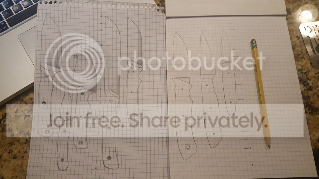

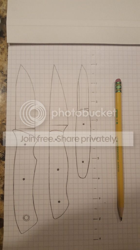

I sketched some more at work tonight. Those are on the graph paper on the left. I got home and toyed around with them a bit more after buying some more grid paper with lighter colored lines. The smaller knives are more to fill the gaps of unused steel on the flat stock... just trying to use as much of it as I can. Those small knives can scale to fit as needed. Any way, I am asking opinions on which knife to strap into the vise and hand file for my first go. Any input is appreciated. Thanks.
I would start with the small one on the right in the bottom photo. Two reasons: First its the easiest design so easy to correct any filing variations. Second its the least amount of material to throw away if you're not happy with the results. Be prepared to toss a few into the "I'll fix that later" box. If it turns out so-so you can use it as a bench knife to remember your first attempt at knife making. Good Luck

On the drawings:
The first page of sketches all have issues. I wouldn't recommend any of them ( the smallest one would be OK, but has minor issues).
On the page with three knives, the middle one is the best handle, but the tip is too pointed. Modify the blade on that one to have an edge more like the larger knife next to it and it would be a great drop point hunter. This is a good first knife project. 3.5" blade and 4" handle is a good ratio.
