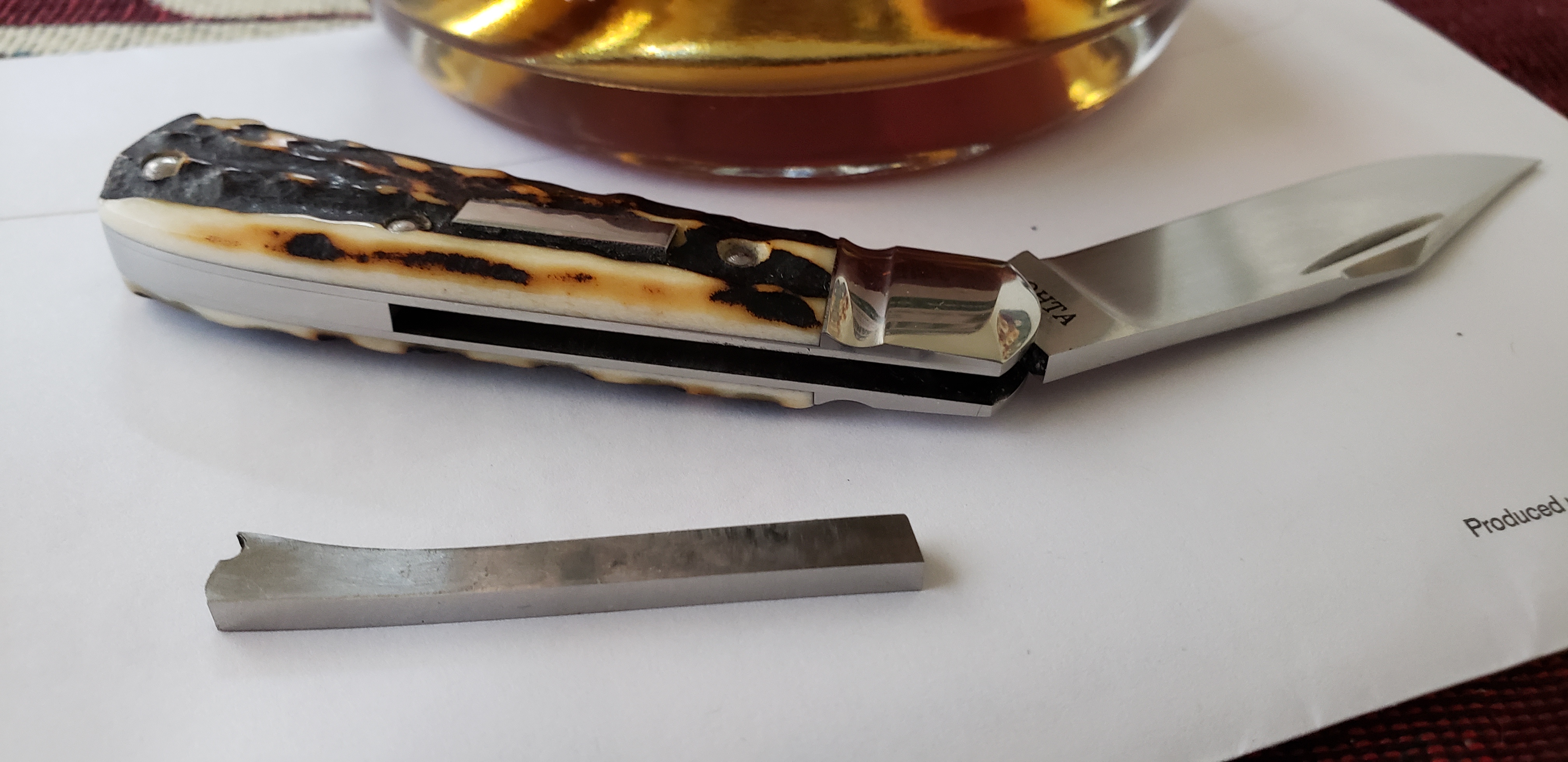

Horrible surprise. Don't want that happening to mine as I understand they're no longer made? Unlike you, I don't have the skill to fashion a new spring either. My one has, I recall, a stainless backspring but carbon blade.
You are correct on both counts, the spring is stainless & yes they are no longer available, I picked mine up in Albacete (Spain) a couple of years ago when I saw it in a shop display knowing they were thin on the ground.

At the top is the old spring C.A glued together, below is where I'm at with the new one.
Cut out of carbon steel sheet (2mm O1 Precision Ground Flat Stock) with a thin cutting disc in an angle grinder (grindette). Now I'm carefully slimming it down with a small bench grinder, more needs to be removed but soon I'll start trial fitting it & removing tiny amounts at a time & then refitting again & so on.
The reason to keep trying it for fit rather than just copying the old spring is that I won't be able to get it absolutely identical by hand, a tiny fraction out on the holes or anything else can make a huge difference to how it works so it's better (for me) to alter it very slowly by regular trial fitting.
Also I can change the shape & get the pull more or less how I like it before heat treatment, which due to being away from my workshop & doing this on my balcony! :oops: means it's going to be an old fashioned style heat treat & temper..........

Yes, tempering is essential after quenching as the steel is fully hard & near glass brittle, the hardness is reduced usually by "baking" in an oven at a set temp for a particular hardness.
The original spring might have been too hard hence it snapping, also to my mind it isn't a great shape with a lot of stress on the thinnest point. I don't know if my logic is correct but when I make a knife from scratch I like the spring as long as possible with a fairly uniform "bendy" section to reduce stress, again just my opinion & by no means scientific.
I'll be "running the colours" (Google it) to temper it which might upset some viewers 😄
Nice job on the repair so far! I'm not surprised that spring broke judging from the length, width and thickness. Must have had a serious pull on it. If you use a propane torch to temper you'll want an even blue colour. Temper it twice for good measure and sand off the blue between tempers.
A bit of time has passed while I was getting on with other stuff but back on this now, the spring has been oil quenched to harden it then tempered by watching the colours as a guide to temperature, not the greatest method but should be fine in this case. Bit of a poor image (apologies) but this is it ready to rivet back up in the knife, it will get a bit slimmer after fitted as the spine will be ground to follow the shape of the knife.
