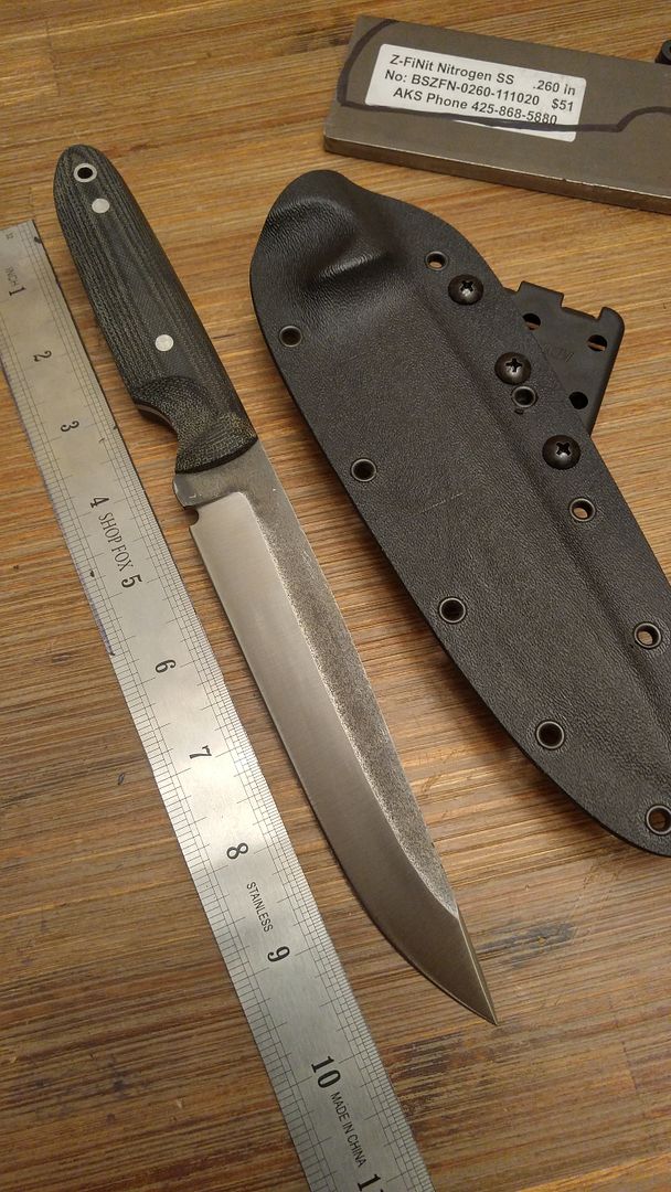

Good call but I think you might have a hard time finding a maker that's overly familiar with that steel. H**l I don't even know anyone that uses a lot of pd#1
I've done 5 knives with the stuff. I hate it... But I'll do it.
You mean Z-FiNit not pd#1 I'm taking it eh? I seen that video on YouTube where it sounds like you just got done a 2 week bender working with that stuff. You sir are a champion.

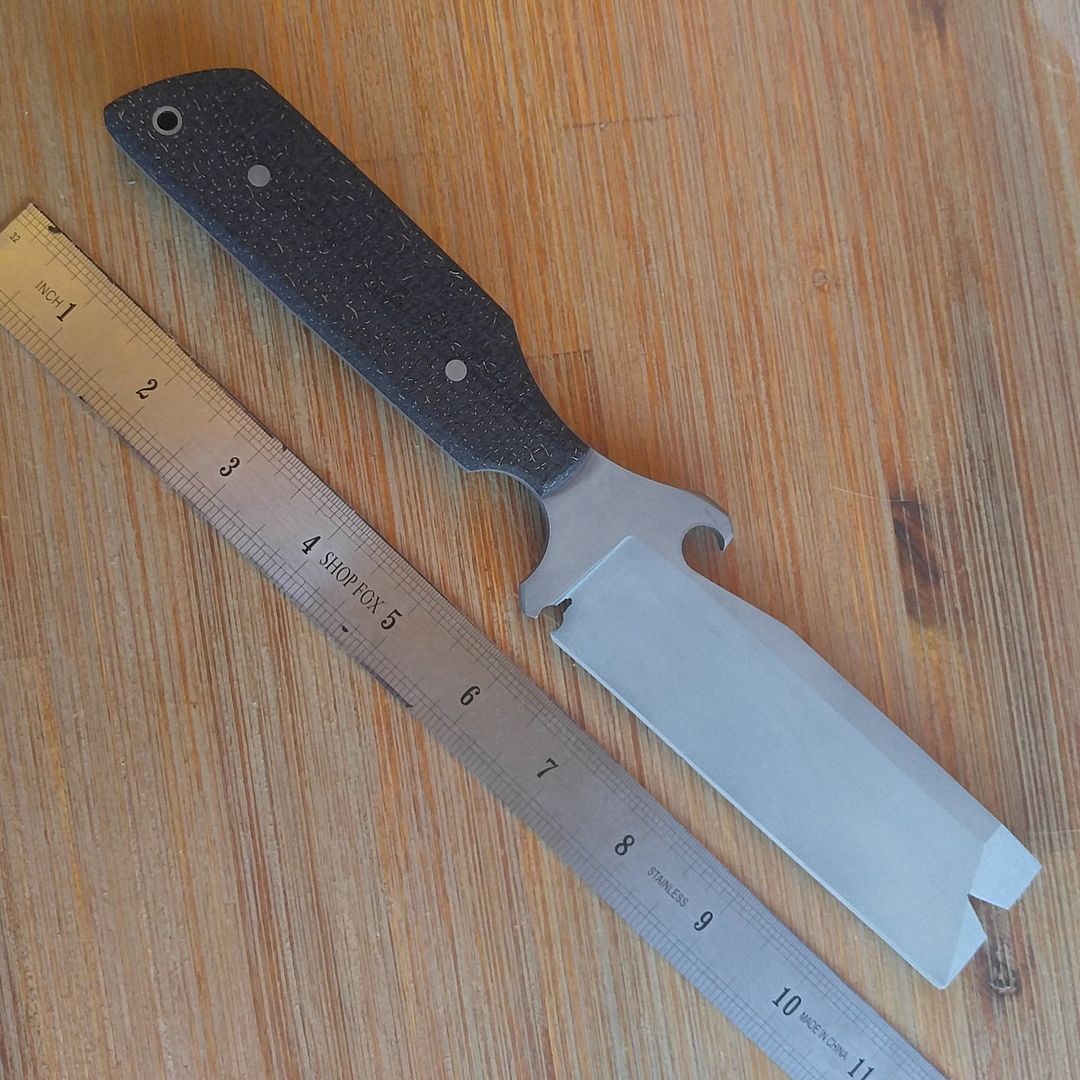

Busse's SR-101 (52100 -ish) does it for me. Hits a sweet spot of price/toughness/edge holding/ease of sharpening that works great for what I do (in larger knives as well). I'd take INFI as well but I've bought mostly SR-101 because I can buy moar knifes at that price point.

I just profiled a 12" overall knife from .220" Spectrumwear with a Portaband on a stand. No fun.
