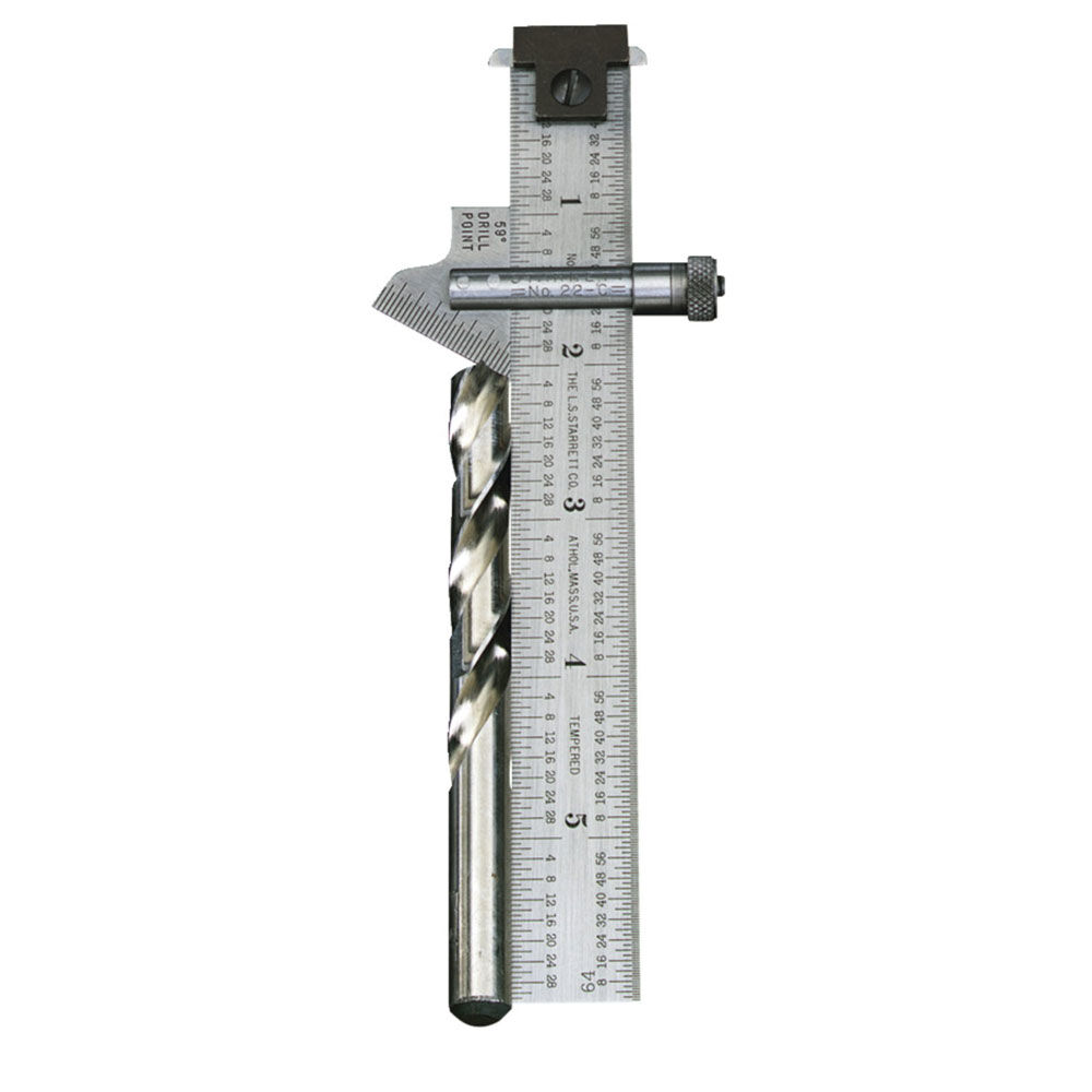

A drill point gauge helps. plus a 10x power loupe or the optivisor.

STARRETT 22C DRILL POINT GAGE​
