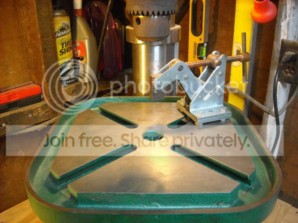

This is what I use to prevent accidents while drilling holes in blades. I would still like to have a vice for other applications (guards and handles for hidden tang), but this little clamp works great for this application. The way I use it prevents any rotation or lifting. It's made by Kant-Twist for those interested.
Johnny Stout did something similar back in July.
